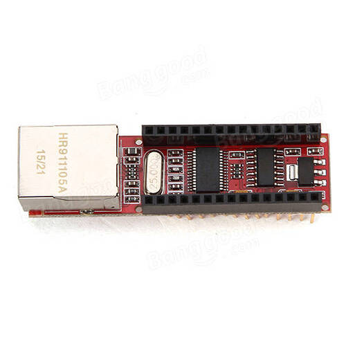

I am totally new into Arduino things. I buy couple of arduinos and those ethernet shields which would connect to internet and send some data to our API.
First problem is i can't get to work my ethernet shield, all the time i don't get any ip address. All wires are connected right, check it 10 times already also i use a lot of different libaries but no success at all.
Can someone help me little bit with it? Also try on other arduino nano, no success so there is no hardware corruption i guess..

It's wired:
SO - D12
SCK - D13
RST - RST
GND - GND
VCC - 3.3V
CS - D10
SI - D11
I am now using this code, i get IP local in Serial monitor, but can't ping this ip from my computer.

I have one of those NANO shields and just plugged it in.
The only change I made was to put the IP address onto my own subnet 192.168.0.115 and it works just fine.
Are you aware of networking protocols, IP ranges, Subnets, etc.
If not brushing up a little may be in order as the sketch you pointed at is perfect apart from the subnet IP.
If you need screen caps of it working I have no issues.
Can you tell me which libary are you using?
As i can see you are not using Ethernet shield ENC28J60, correct?
I "AM" using the Ethernet shield ENC28J60.
Using the standard UIPEthernet lib.
I can change to a different ethernet shield but you were pretty clear its the ENC28J60
This one to be precise

I get output:
IP Address: 192.168.1.115
But when i try open this IP in browser doesn't open anything.
What is your subnet IP range ?
Check the DHCP list in your router or if you are on windows open a command prompt and type "ipconfig /all"
Check the "Default gateway IP to get the range (normally 192,168,0.1) or if its a little older then it may actually be as you said and show 192.165.1.115.
Some of the nastier routers may also have ranges cut down too to under 100. but thats not too often.
Left you enough clues to get going and that it shows that IP (presumably in serial monitor) means the sketch ran fine so thats probably not the issue and chances are neither is your Ethernet module.
