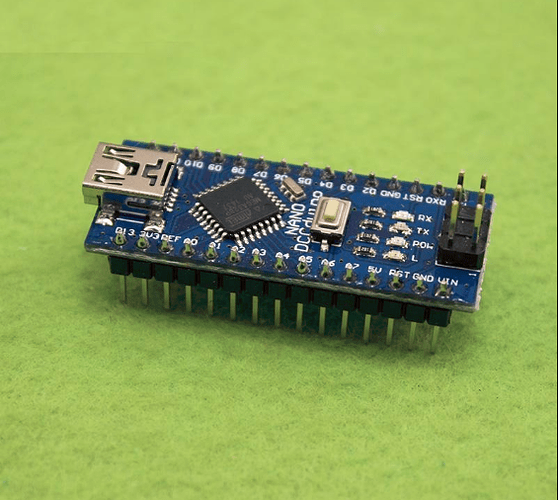

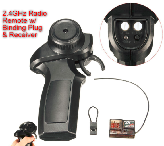

I'm interested in using an Arduino Nano to decipher a 2.4Ghz radio remote receiver signal and transform it into a hall effect sensor signal output to a DC motor controller for remote motor speed control. No brakes, steering, motor direction or any other controls, just to turn PPM signal from rc remote receiver into hall effect PWM signal for motor speed control only. What pins on the nano do I connect the rc receiver to? What pins do I connect from the output of the Nano to the motor controller (+5v, sensor, Gnd)? Which code should I use to program the Nano? I also understand there are I believe two resistors I am also supposed to connect to the circuit (10K & 100K) I believe the 10K resistor goes between the Gnd and the +5v pins of the Nano output but I am unclear where the 100K resistor goes.

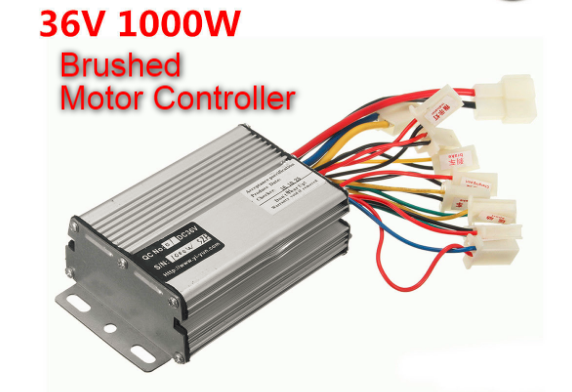

Currently, I have 36vbdc motor powered with a 36v li-ion battery and controlled with a brushed DC motor controller which uses the output of a corded hall effect sensor for the throttle. I am trying to replace the corded hall effect throttle with a 2.4Ghz radio remote using the Nano to decipher the signal and transmit it to the motor controller. I have included pics of the electronics.
Any help would be greatly appreciated. Thank you.

O.k. You can connect the receiver channel outputs to any of digital pins on the Nano you feel like.
But the Nano does not have a DAC so there is no practical way that you can get 0-5V analog signals out of it. If your motor controller really needs signals like that then you're in trouble. Many motor controllers have alternative inputs but since you don't want to give any details of what controller you're using I can't help you there.
