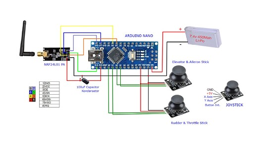

i've following the transmitter steps and the connection very carefully and re-check the connection, after all set, i try to add code, here the problem happen.
for the transmitter i use 2x analog joystick, then i use header pin to plug it into the circuit, when it plugged and try to code, it says
"avrdude: ser_open(): can't open device "\.\COM7": The system cannot find the file specified."
but after i remove it, it can be seen in device manager.
i try to replug, restart my laptop, etc. but it still doesn't work.
anyone know what's happen ;(

i mean, i use the receiver with arduino nano and nrf24l01, but it can upload flawlessly.
and for the transmitter, when nano is plugged in, the com is disappeared.

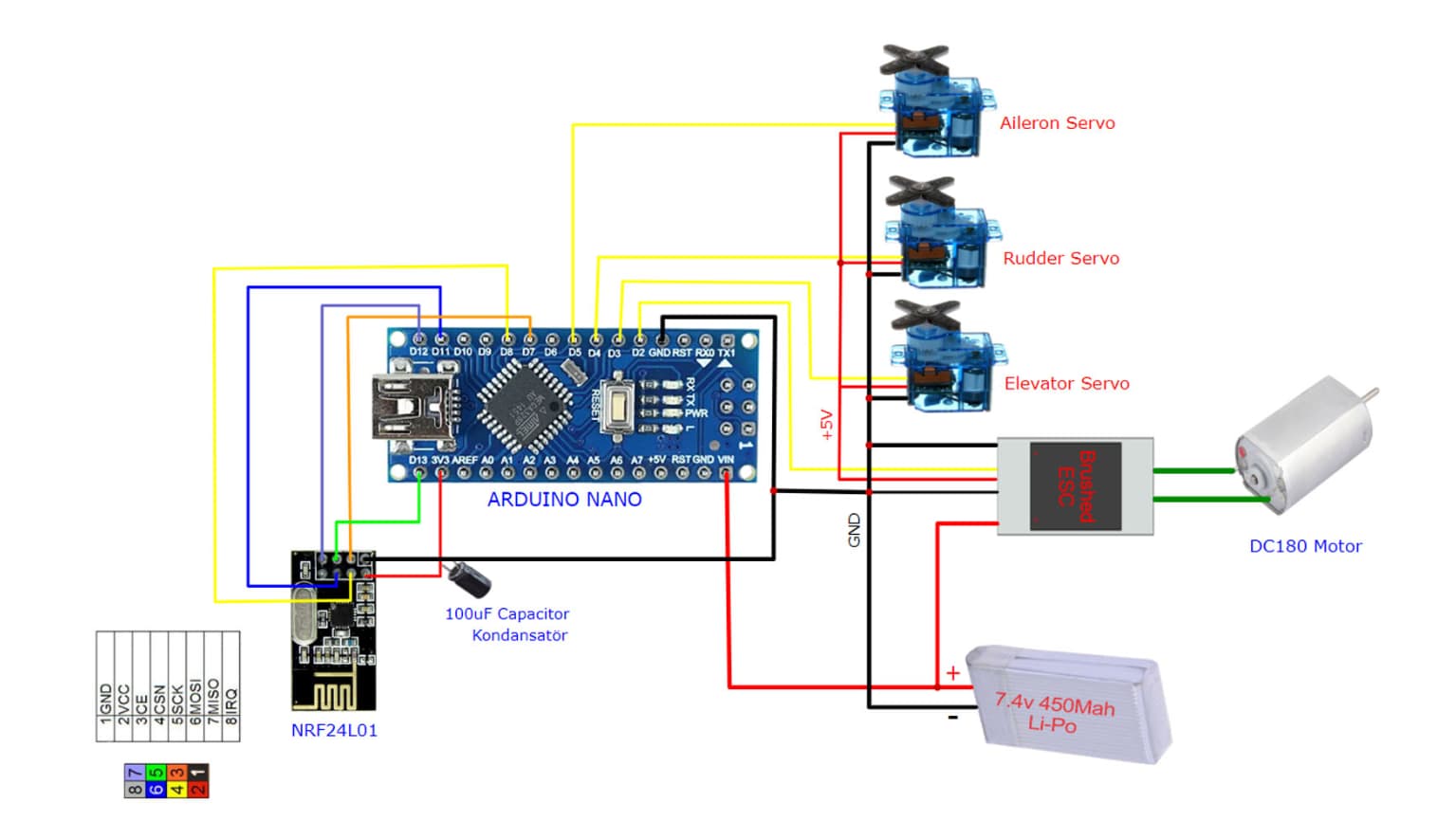

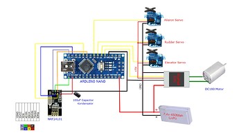

i use this circuit diagram
transmitter
receiver.

Use separate power supplies for NANO and then everything else. The NANO is NOT a power source for these parts.

i've been realized that when i disconnect the solder from 3v3 to VIN NRF24L01, it can be readed in my laptop, and the function of the joystick is normal.

something strange happen, today i tried to add ams1117, when ams vout not connected to NRF24L01 it says 3.3v. but when i connect to the vcc of the NRF24L01 the voltage is disappear but the ams117 is warm.
any chance if the NRF24L01 is broken? how to test NRF24L01?
II think there is a good chance. It is true that the "NRF24L01 PA LNA" modules have a significantly higher maximum current draw:
https://github.com/nRF24/RF24/blob/master/COMMON_ISSUES.md#my-palna-module-fails-to-transmit
Stronger power source. Below is a chart of advertised current requirements that many MCU boards’ 3V regulators may not be able to provide (after supplying power to internal components).
Specification Value
Emission mode current(peak) 115 mA
Receive Mode current(peak) 45 mA
Power-down mode current 4.2 µA
And although the current capacity of the AMS1117 is dependent on heat sinking, which might not be provided effectively in your system.
However, it is still unexpected that a properly working nRF24L01 module would cause the voltage regulator to shut down as seems to have happened to you. It seems more likely that there is a short on the module, or in the wiring between the module and external components.
I would start by doing a careful visual examination of the module. Look out for any conductive debris such as little balls of solder or bits of wire stuck to the board. Also watch for any burnt or discolored looking parts of the PCB and components.
Carefully check your wiring between the Nano, the AMS1117 and the nRF24L01 module to make sure everything is correct.
The nRF24L01 module from the receiver does not produce this fault so you can remove it from the receiver's circuit and swap it out for the potentially problematic module on the transmitter. If the problem no longer occurs after doing that, you will know that the other nRF24L01 module is bad and needs to be replaced.
I seen some white grayish color near all the pin in nRF24L01, and any tips how to check the shorted NRF24L01module with multimeter?
