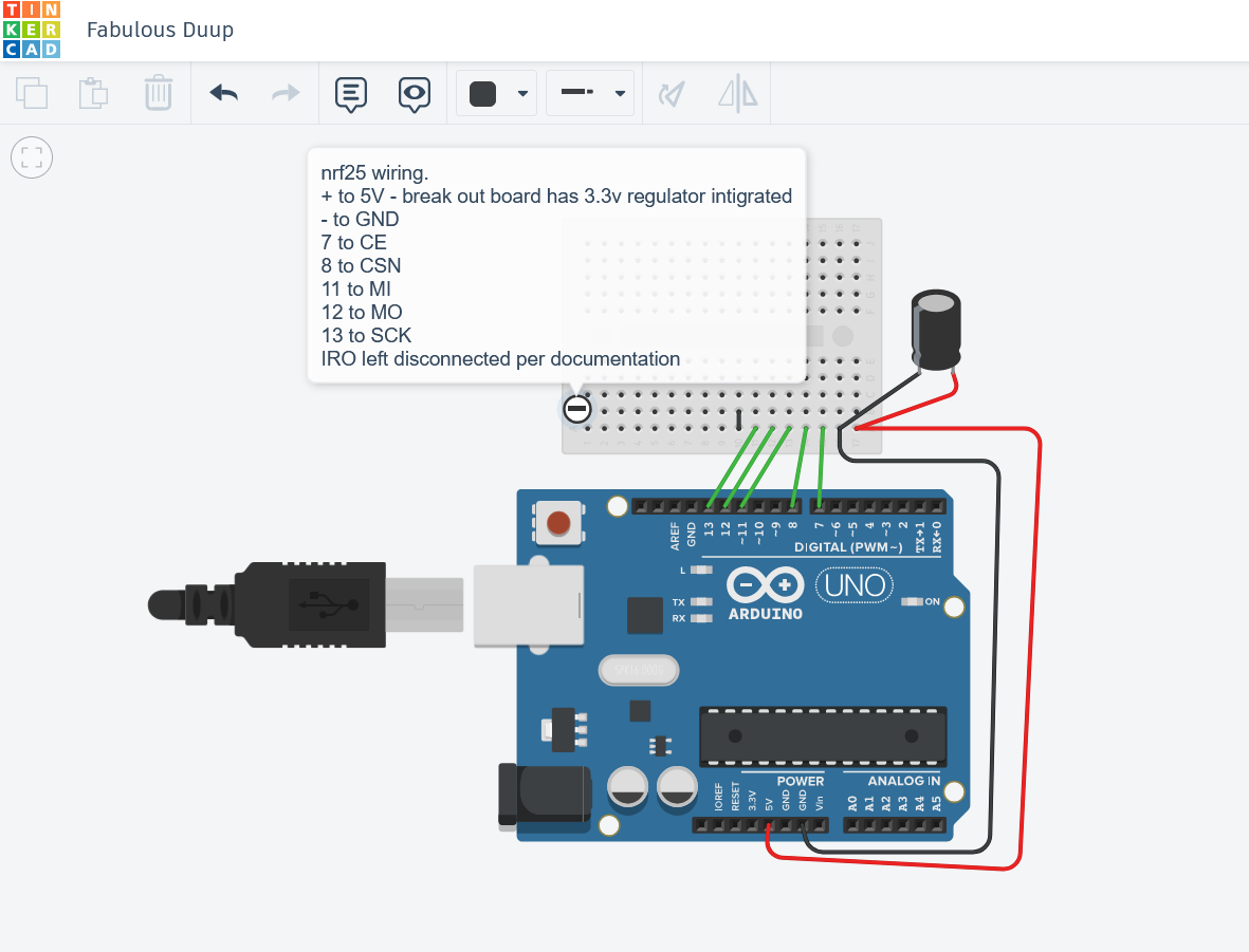

Please explain this and post an annotated schematic of what you have built, be sure to show all power sources, grounds and note any wires over 10"/25cm in length.
How far apart are the transmitter and receiver from each other?
I do not that is why I am asking for an annotated schematic.
Um.... Ive never done a cad schematic before this and this was my first time using tinkercad for a wiring thing. they didnt have an NRF25 board so I improvised.
So to answer your questions, right now I have just the NRF25 and Arduino hooked up. capacitor bridging the + and GND at the NRF24 break out board (as recommended by documentation and users.) I am using 6 inch male to female pin jumper wires. the only long wires are the usb cables going from the arduinos to my laptop. the transmitter and receivers are about 3 ft apart

Using the Arduino as a power supply is not a good idea.
Power Stability Issues with RF24 Radio Modules
As described in the RF24 Common Issues Guide, radio modules, especially the PA+LNA versions, are highly reliant on a stable power source. The 3.3V output from Arduino is not stable enough for these modules in many applications. While they may work with an inadequate power supply, you may experience lost packets or reduced reception compared to modules powered by a more stable source.

Like I mentioned in the picture I already added capacitors to the transmitter and receiver. I also note I mentioned I have a couple 2 cell 18650 battery packs with 5V buck converters I can use if needed. I'll try this evening again powering the NRF24's with those.
Question remains with the code, what debugging could I add to try and get them to talk. or using the same libraries is there a simple code to see if A will talk to B or something. I've been using ChatGTP to troubleshoot this code for the last month and i end up getting in the same loop of try this , try that, try this again, try that again. I get frustrated shut off the computer and go to bed. Thats why I asked for help here. hopeing someone else has gotten these to work with the same equipment.
Your picture does not convey the information needed to resolve your problem. An annotated schematic is needed. You can draw it by hand but it must be clear and legible. Plan on separate power supplies for the radios.
