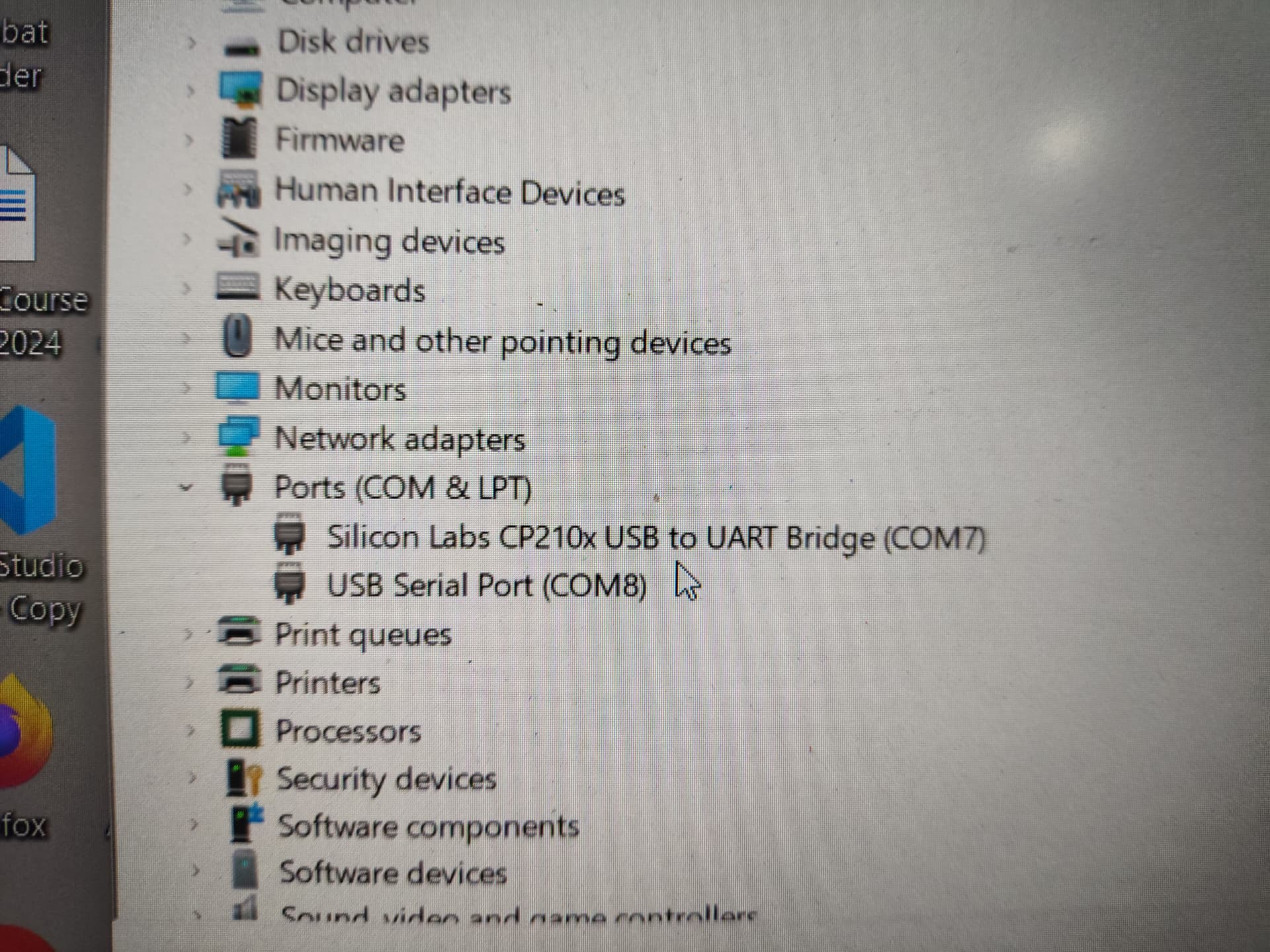

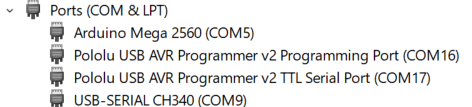

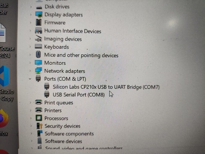

That's good. What does Windows device manager think of your board? You should see a USB-Serial CH340 like the last entry below when the board is connected; ignore that it's a different port.
It's an FTDI because even after connecting from phone it shows FTDI device connected
It's detecting my esp32 but in the case of Arduino nano It's showing USB serial port. I think I should delete the drivers and Install them again

Now add a reply here on the forum thread to tell us what it says in the "Manufacturer" field of that dialog (e.g., "FTDI", "wch.cn")
It's from FTDI
