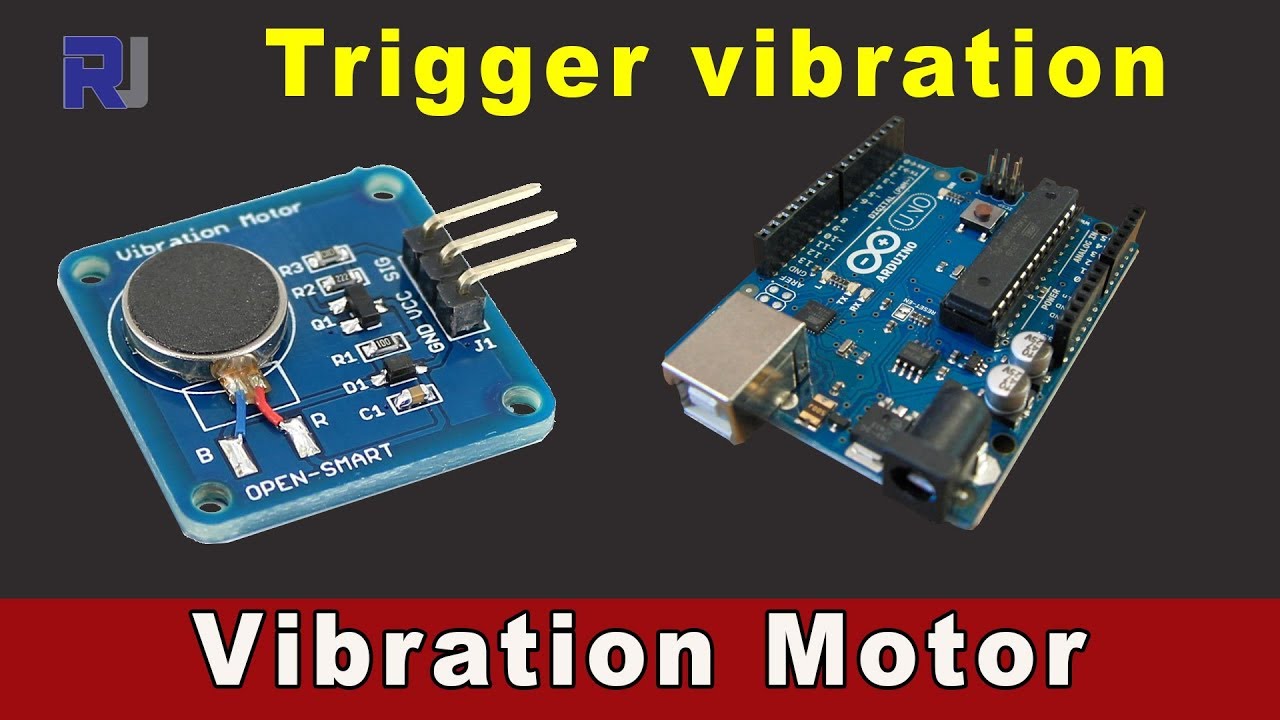

I tried to create a diagram for connecting 1 grove vibration motor to arduino nano:
did I do this right: where would the transistor and resistors go-what pins would they be connected to?
The transistor and resistor are installed on the Grove vibration motor module.
Connect IN on that module to a digital output to control it.
any digital output?
Any digital output.
Ok, thank you!
