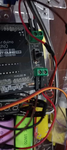

I am trying to run 4 motors connected to Digital Pins 4,5,6 and 7. For the 4th and 5th two motors are connected and respectively for the 5th and 6th. I am here using my own Motor controller with a L293D chip. It worked fine before with only two motors but now when I connect 4 motors the Arduino LED on-board flashes and dims and the Arduino restarts. But when it is connected to the USB it kind of works as the motors spin slowly. The batteries I'm using here are 3 Lithium ion batteries which have 12V and 3600 mAh when combined. Also, I cannot use 8 volts for this as the Onboard LED straight up goes dark. Power is supplied to the vin pin. What should I do in order to fix this?

Yes here i will post pictures of it

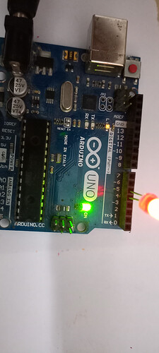

I did what you said.
In the first scenario, i noticed the onboard led wasn't lighted
Second picture(ill post it down), when i connected the LED to the intended motor pins it blinks rapidly. I never programmed it to be blinking. And the onboard LED lights up faintly.
Pretty sure the board is broken.
Driving an LED by port pins, without using a current limiting resistor tends to burn out the port pins.
So do you think the board is broken? And how would you think it should have been broken.
