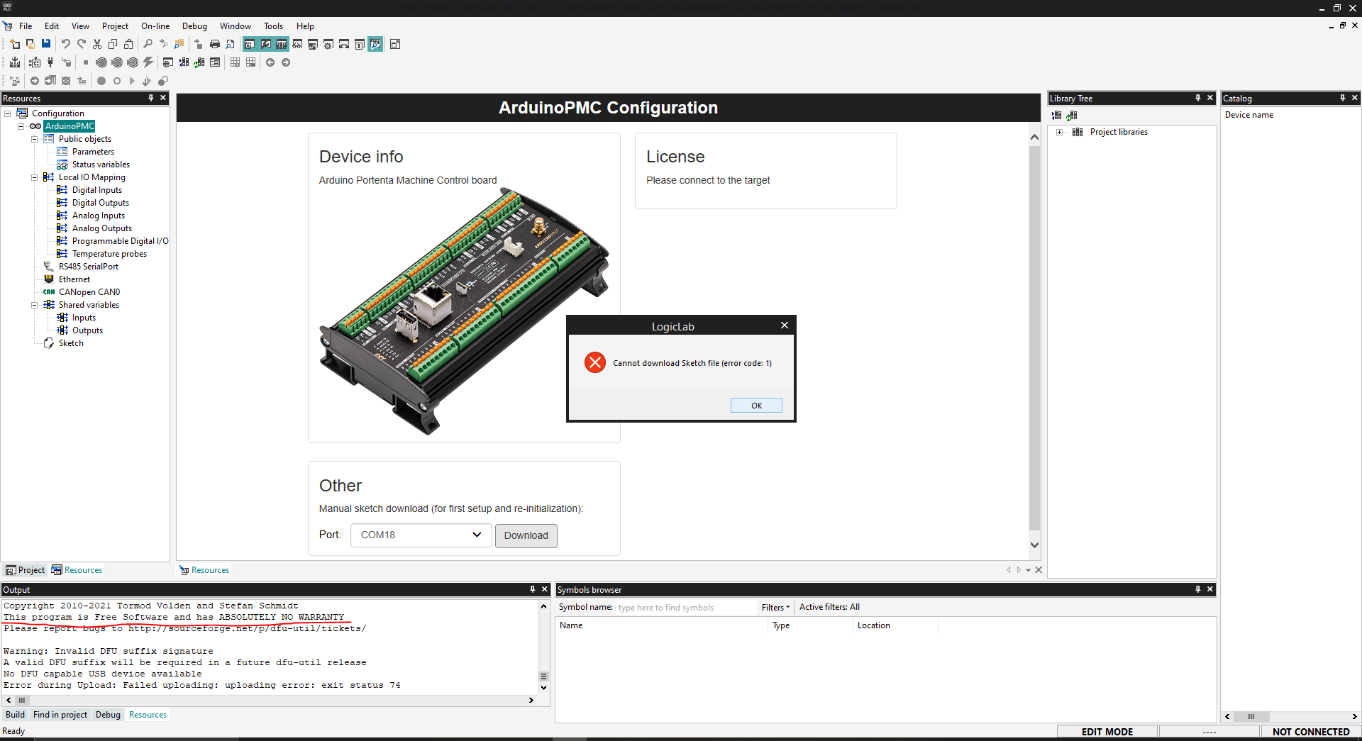

Realized I had missed the first step, which was to click "download" on the main serial port.
However I then ran into this message:

The "Invalid DFU suffix signature" should not be a problem (I think):
I get it every time I upload to the PMC in the normal IDE.
What's the 1st step?
Ah... I clicked the "Download" button and got a same result as you did. :frowning:

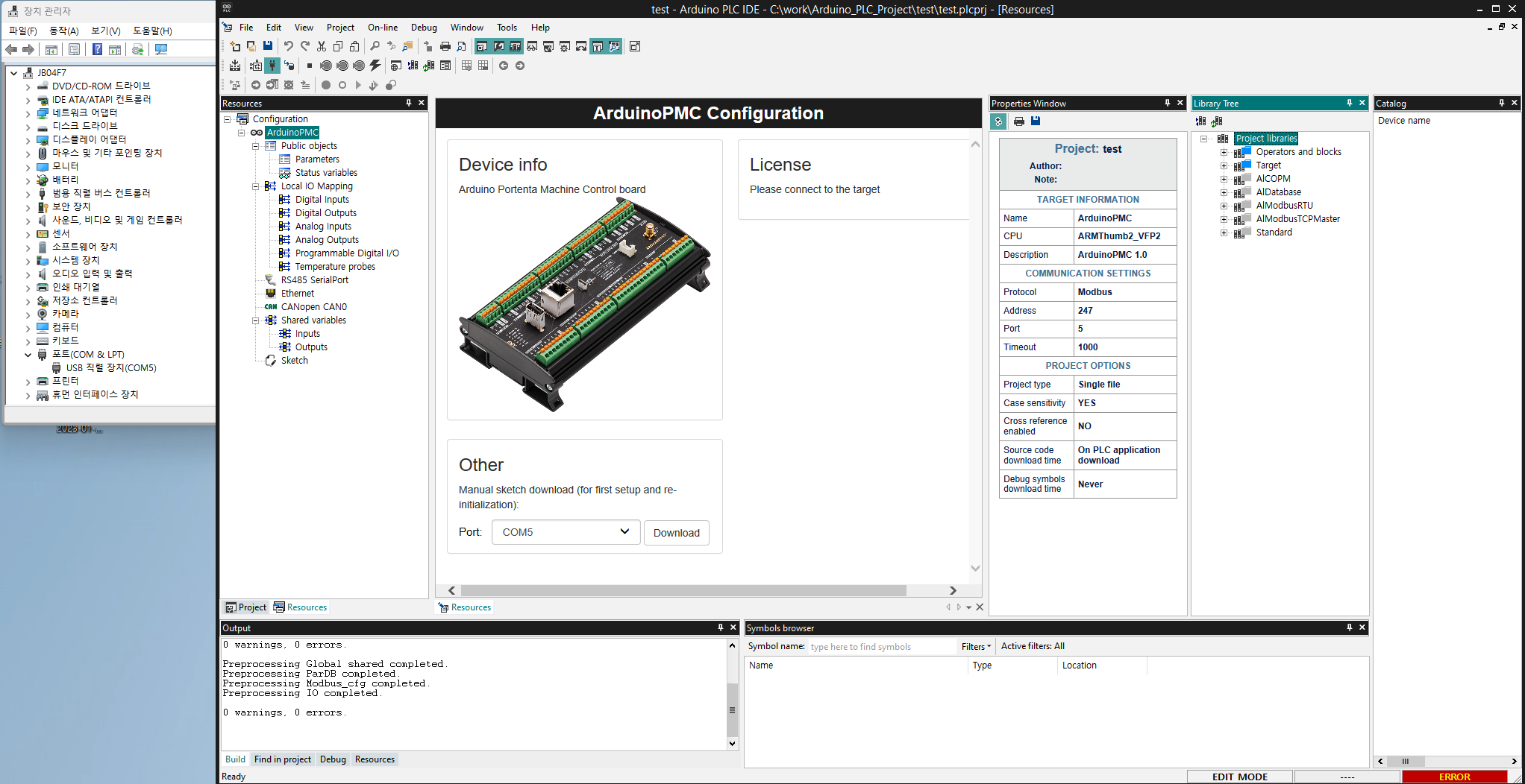

I installed the Arduino PLC IDE & Arduino PLC tools.
In step 4, I clicked the Download button then I have below message.

Warning: Invalid DFU suffix signature
A valid DFU suffix will be required in a future dfu-util release
No DFU capable USB device available
Error during Upload: Failed uploading: uploading error: exit status 74
  1. There are some corrupted message like this.
    ?ใ…ผ?็งป์„Ž๋’— ?๊พจ์คˆๆดน๋ชƒ์˜ฉ ?ย€??ๆ€จ๋“ฆ์ป™ 431588 ่ซ›๋ถฟ์” ??21%)็‘œ??ัŠ์Šœ. ๏งค์’•? 1966080 ่ซ›๋ถฟ์” ??
    ?๊พฉ๋ฟญ ่น‚ย€?์„Ž๋’— ?์ˆˆ์Ÿป ๏งŽ๋ถพใˆ็”ฑ?195072่ซ›๋ถฟ์” ??37%)็‘œ??ัŠ์Šœ, 328552่ซ›๋ถฟ์” ?๋ช„์“ฝ ๏งžย€????์„? ?โ‘ฅ์“ฌ. ๏งค์’•???523624 ่ซ›๋ถฟ์” ??
  2. DFU error
I used the virtual environment(Parallels Desktop) and using the USB Hub.
So these may be the cause of the problem so I don't use the USB hub and did it with Windows desktop. Then I can activate the license. :slight_smile:
