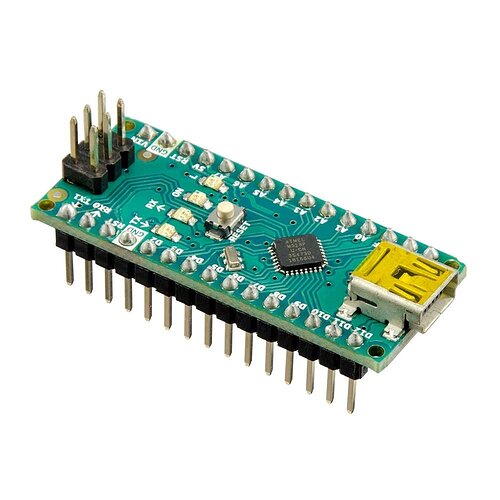

I also might add a light to the arduino that I can turn on with a web app? or do I need a special arduino board for wifi?

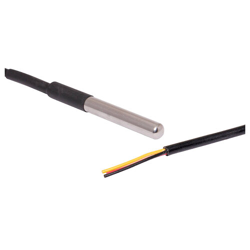

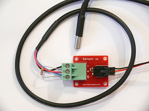

For measuring the temperature: those DS18B20 probes should do the job just fine, and as long as you keep your Arduino properly isolated from the mains power there should be no way for the high voltage to reach the water.
The hardest part may be the distance of the probes from your control board: you're talking about a water heater on the roof, and a pool, and a pump - three items that are probably at quite some distance from one another. Long wires may pick up a lot of noise, which can result in poor readings.

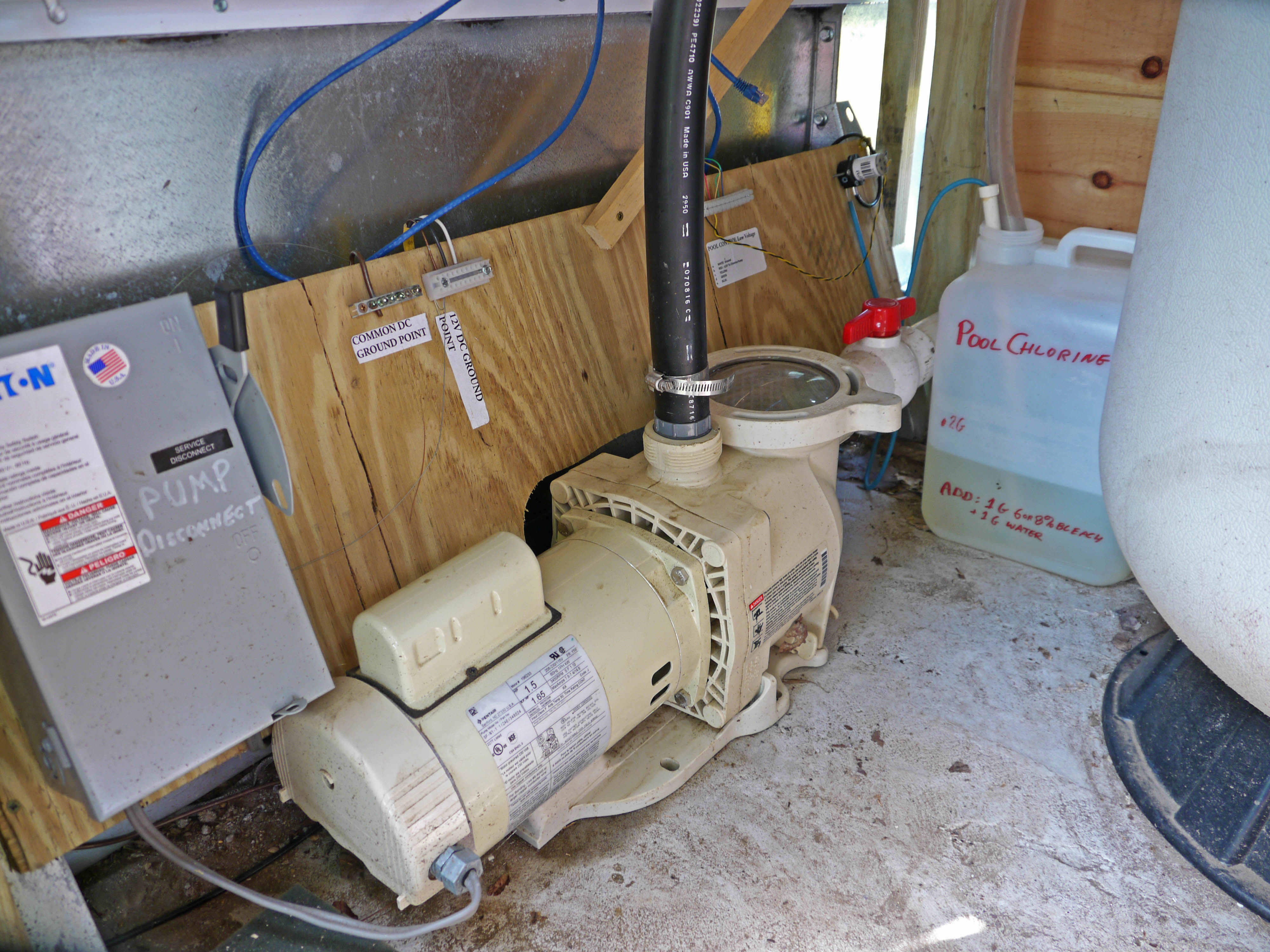

I also do the Chlorine dosage twice a day. Great for when you go away for a while.. Here's my pump and on the far upper right the small peristaltic pump for Chlorine. Keeps the chlorine at 3 to 5 ppm and never smells like chlorine when swimming.

as for the Web enabled part, that would mean the use of something like an ESP8266 and that you have WiFi within range.
