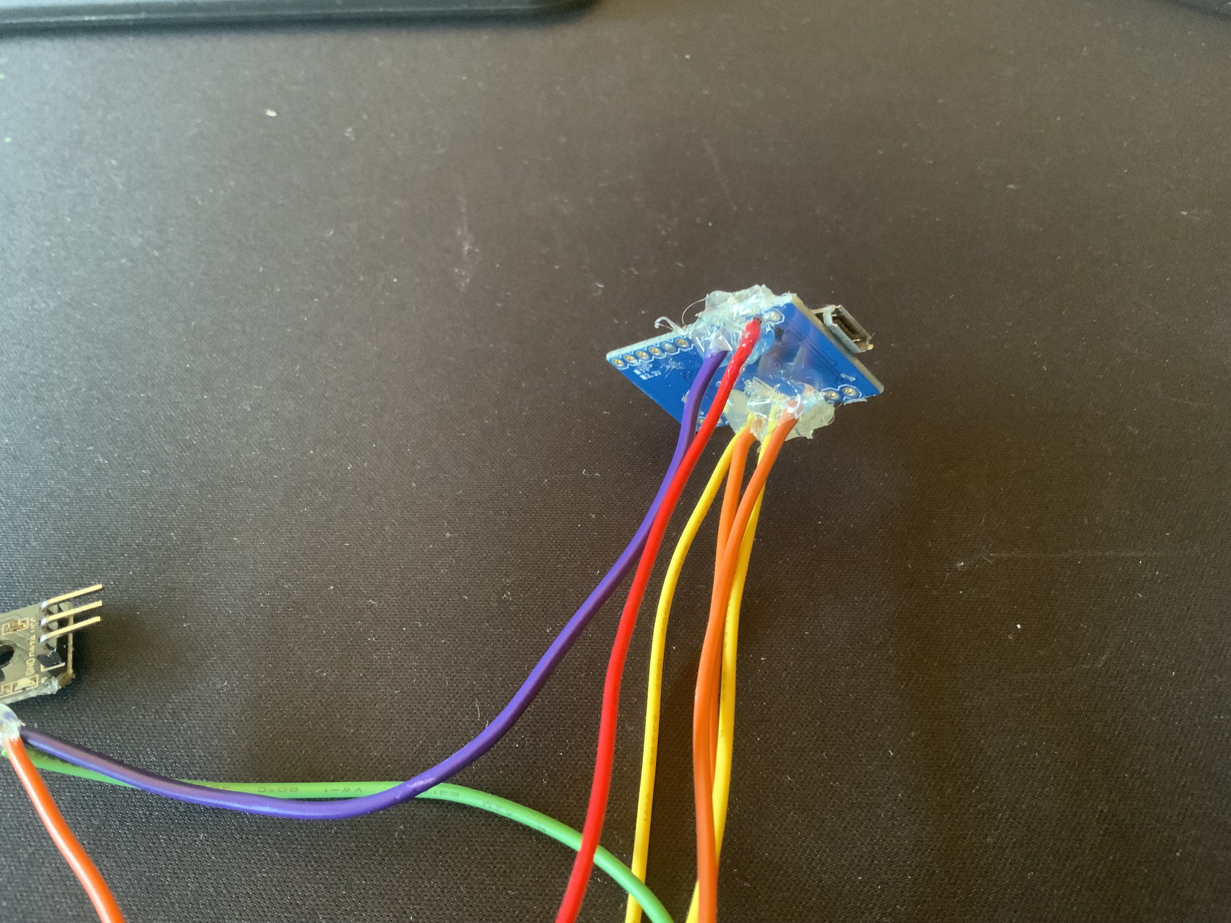

i have problems with the dht11 sensor. I soldered it but nothing works and i do not receive any readable data.

Please show a schematic of your project and a good photograph that clearly shows how everything is connected. Upload the code you're running and describe what behavior it exhibits, and what the intended behavior is.
I just prepared it a bit and soldered it again and the sensor is attached to the cable again. With soldering everything is fine, I think. The code checks whether the sensor is working and if there is no response from the sensor it gives a reading error. The code is from chtgpt because unfortunately I'm not familiar with it
I don't think so.
You used hot glue. That has nothing to do with soldering.
Where is the common GND and how is this sensor supposed to be powered?

I considered that, but it doesn't look like it. I'm afraid it's hot glue all the way - which, coincidentally, is a pretty good electrical insulator.
its not soldert it only look like so
but why the sensor doesnt work
Yep, so that's why it doesn't work. There needs to be an electrical contact on those joins. Hot glue doesn't do the trick. You'll have to remove it and use a soldering iron and actual solder; I recommend regular solder, not the lead-free stuff. Use flux-core solder, and/or apply additional flux as well. Keep in mind that plumber's solder is not appropriate here either; you'll need to use materials specifically for electronics. The good news is that all this is cheap and easy to purchase.
1: it has no electrical contact with the rest of the system
2: it doesn't share a GND connection with the Arduino
3: it doesn't have a power supply.
That's just the hardware side; let's focus on that first. Keep in mind it's not an either/or situation - you need to fix all three aspects.

Yes, well, of sorts. I can't guaranteed those connections are reliable, though. The quality of the soldering leaves something to be desired. Keep practicing!
Can you show how the sensor is connected to the Arduino?

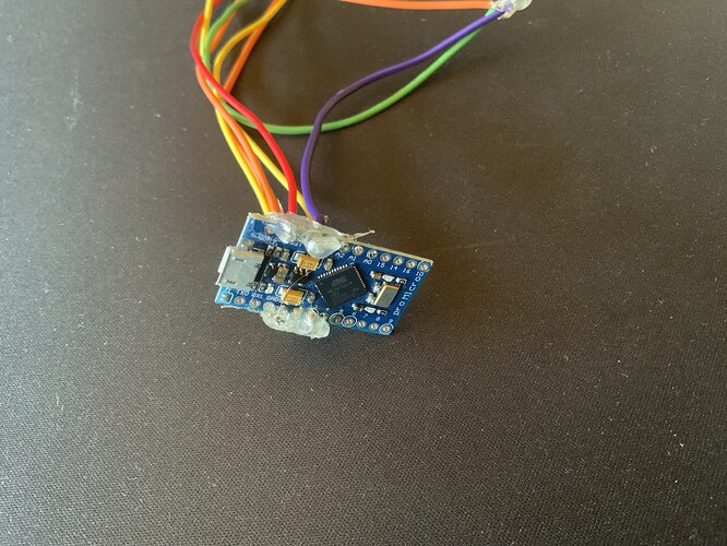

What about the Pro Micro? Also soldered?
If yes, I suggest that you start with an example that comes with the DHT library that you use.
The cables are also soldered to the Aruino, what does the code look like now?
