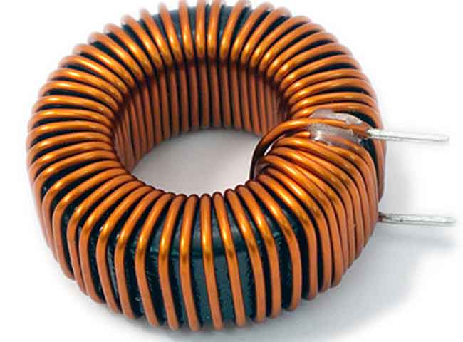

Hi, before I post this question. I have already separate the power like you said. The EMI/spike still there. I think the problem because the load is too high.
Using ferrite corite, what does it mean of 5 turns, is it diameter? Let say, I have load around 8 Ampere. Which ferrite corite should i buy?

Great explanation. So, the electricity come to Arduino by RF (Radio Frequency), right? I will try with ferrite toroid but I wonder which should I buy?
It means to wrap the wire through the hole (5 passes through). If you count the number of conductors going through the hole, that is the exact number of turns. A wire going straight through the hole is 1 turn. The exact number of turns isn't critical, but if there's room, I would shoot for up to 10.
Most any ferrite core would work (any in your images look OK) ... here's one with an inductance factor of 5.4µH.

hi, with 5.4µH how much load current (Ampere) can take? Is that any formula with this?
Number of turns is not critical, but if there is a room, can i shoot up till maximum?
Oya, what kind of cable should I use to this (diameter)?
Not an expert with this ... here's more info on the core: SIFERRIT material T35
More reference: The Use of Soft Ferrites for Interference Suppression
The total current seen by the core is the Ampere-Turns. For 8 Amps and 5 Turns, there is 40AT
For 8 amps, I wouldn't use anything smaller than #16 wire. 16 AWG or 14 AWG stranded or solid are OK.
I think too many turns could have negative effects (power loss, heating), so if a few turns or more solves the interference problem, I wouldn't add much more beyond that.
Check the voltage at the load to make sure there's not too much voltage drop.
