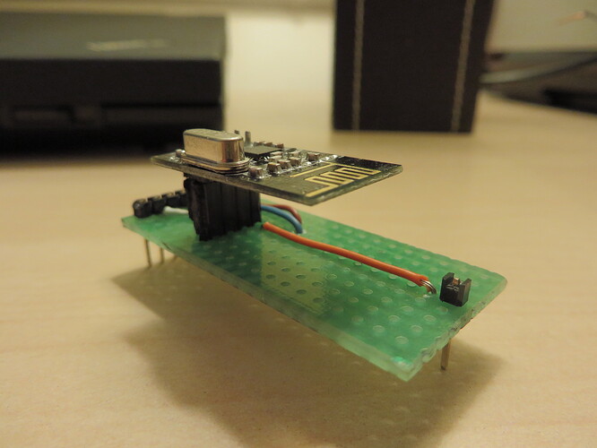

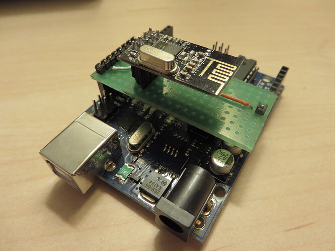

And now, more importantly, the arduino-ish side of the story. I had the Uno. Clone. I had a bunch of cables connecting it to the RF24 module. THat sucked. So I created a "shield" for the nRF24L01+:
And the shield on the Uno:
That worked a lot better. I tested all 10 moduled I had, and every single one worked fine. nothing wrong with them. The claims that the range is a lot more than it actually is, I don;t care about that. They;re dirt cheap, and not too badly built.
This one is currently chatting away, telling the Rpi at least two times per minute what temperature it is in the study. So it works.

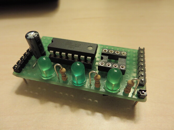

Enter the Attiny. I wanted low power and not too often having to change batteries. So, that's what I'm working on now.
I created a second shield for programming the tiny with ArduinoISP (info on google and everywhere in the forums, not many people build the three leds on it though, they are (from left to right) heartbeat, error, comms, see ArduinoISP code comments):

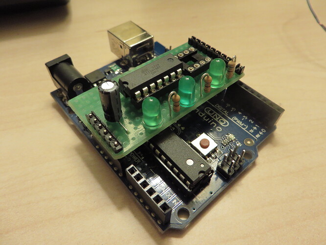

And again, on the uno:
After some soldering, re-soldering, tweaking some connections and replacing the 10uF cap (bad one), I finally got it to work (took me half a day for god's sake :slight_smile: ). The worst was that when I was testing the tiny I was programming, I continually kept holding the LED the wrong way around (I cut the leads to the same length, stupid me :* ).

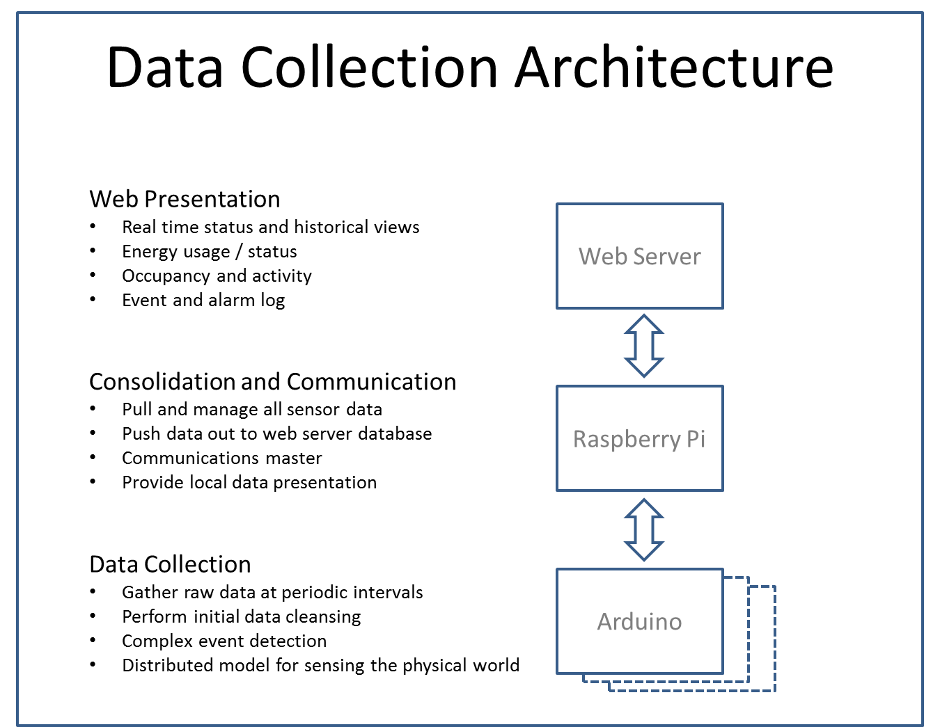

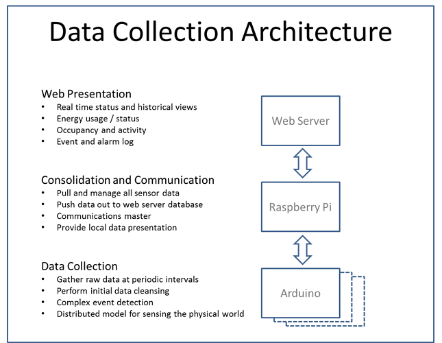

Interesting. I know lots of folks have built these before, but they are a great way to learn. I am working something very similar to support my vacation home which is 2000 miles away. My aim is to measure and extend the information up to the web and then make it available through my mobile device. The architecture is here (tried to make the picture larger but had to attach it instead):
I have a fair amount of the Arduino code written to measure environmentals, mechanicals, occupancy, events and alarms, etc. I was using the Uno, but stepped back and rewrote it for the Due. I am back up and running with most of that original functionality, and just tonight finding some time to continue work.
The Pi is intended as the consolidation layer within the house. I had spent a fair amount of time trying to get my Arduino's reliably talking directly to a web server. I had them calling PHP scripts, which loaded attached data to MySQL on the webserver. But it seemed a bit too fragile, so I decided to add the Pi locally as the consolidation point which would then can use a more robust transfer mechanism up to the webserver. Tonight I implemented a protocol between the Arduino and Pi so that I can manage a rather diverse set of commands and parameters between the Arduinos and the Pi. Next on my list is fixing the data architecture and replacing data 'stubs' with the real deal.
As far as the web layer goes, I am expecting to have the primary MySQL database there. (Local DB will continue to remain, primarily for consolidation multiple Arduinos, and maybe a local display for troubleshooting.) I have tried a couple JavaScript frameworks, and believe I have settled on Sencha EXT JS. Tons of functionality. And I am tempted by their visual designer and may spring the money for that when the times comes.
Very good fun. A rather slow process due to priorities, but satisfying regardless. I head out to the house for a vacation in February, and am hoping to have something proven enough to leave behind at that time. The clock is ticking!

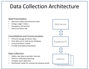

We're thinking along the same lines :slight_smile:
I had drawn something like that before, a bit old-ish, but ...
I might drop the sql/webserver on NAS idea though, it seems more logical to have everything contained on the RasPi. On the other hand I have some experience with the raspi eating two of my SD cards, and the loss of data wouldn;t be all that nice...
