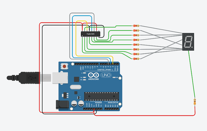

played a little on thinkercad and have a working 1 digit 0.8 anode segment display that counts from 9 to 0.
the arduino is connected to a shift register 74HC595 that goes to a ULN2803apg (reason is when i start with the bigger display), both anode com's are connected to the +5v with a 33O ohm resistor.

numbers 9, 8, 6, 5, 4, 3 and 2 are less bright then numbers 7 and 1. why is this and how can i fix it.

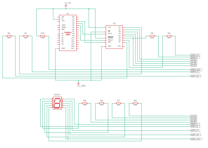

Post a schematic. It seems like more segments means dimmer segments.

problem is that i can not give you the scematics, because the ULN2803A does not exist in tinkercad
each output from the shift register goes into an input of the ULN2803A then each output is connected to the segment pins of my display
  • You use a pencil, a paper, and camera to generate the schematic.
this is what is have in tinkercad
the resistors between the shift register and display segment needs to be replace with the ULN2803a
not using the resistors on the tinkercad scheme, it's a ULN2803A.
but i have the same problem when using 220 ohm resistors in stead of the ULN2803A
  • You need similar:
thank you LarryD i did not connected the common from the ULN2803a towards the 5V, now the digit's are nice and bright :slightly_smiling_face:

As drawn by @LarryD in post#13. If you try to put one resistor on the common pin, then the segment intensity varies with the number of segments lit; one per segment makes the current flow independent.
You will, however, draw more current with the individual resistors. With 220 ohms per LED, your current flow will be around 16 milliamperes per LED. When all segments are lit, you’re drawing 16*8 = 128 ma from the Arduino. That’s pushing the onboard regulator, if your not using USB for power.
