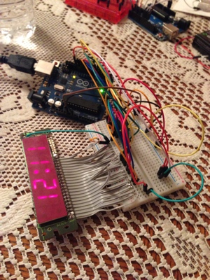

HI I am using a 30-pin 4 digit display i ripped out of an alarm clock. With luck I found that someone had done the same thing with the same model number and made this schematic:
From my understanding, for most segments, you activate one of the two grounds on the circuit (pin 1 or pin 2) to select one of two segments. I confirmed that this works..you can see in this video here: (http://www.youtube.com/watch?v=aaz4ETmIJv0)
I set up my arduino like so:
Arduino pins 2,3,4,5,6,7 - (handling pins 16-21 from display) Arduino pins 8, 9, 10 - 74HC595 8 bit shift register (handling 5,6,9,10,12,13,14,15 pins from display) Arduino pin 11 ** - Two center dots (pin 30 from display) **Arduino pin 12, 13 - ground 1 (pin 1) + ground 2 (pin 2) My issue is how to program it....because to print numbers, you will always need ground 1 for a segment on pin x but ground 2 for a segment on pin y at the same time.
I attempted to use delay(5) in between pinMode changes of the ground ...but this is not perfect as it doesnt really work with the shift register, and doesnt seem like it would be the properly ..
Anyone have any clue, I am a newbie! thanks so much!
-chris

You do not need to change the pin mode. You do need resistors in line with the LEDs. You need to multiplex the display, that is display some segments for a short time and then swap over and display the others. Done rapidly enough it will look like they are on all the time.
cjm771: My issue is how to program it....because to print numbers, you will always need ground 1 for a segment on pin x but ground 2 for a segment on pin y at the same time.
You alternate quickly between the two sets of LEDs. Persistence of vision does the rest.
The word "multiplexing" in the name of the forum...? That's what this technique is called.
Yes but in the scheme, 2 segments LEDs are controlled by 1 pin and the ground is what can change.. Is this not right? How can I alternate 2 LEDs from that one pin?
Yes it is right. It is simple, you set the anode high and the cathode low to light only one segment. If the other cathode is set low then you do not set the anode high if you do not want the segment on.
cjm771: Yes but in the scheme, 2 segments LEDs are controlled by 1 pin and the ground is what can change.. Is this not right? How can I alternate 2 LEDs from that one pin?
The input voltage isn't fixed. It has to change to match the LED that's connected to ground.
Ok thanks I think this works with the LEDs connected to pins directly, but for some reason it doesn’t work properly with the shift register LEDs , I think it has something to do with the 2 gnds and 2 vccs connected to it…which when setting a segment on… it either enables 2 segments or none…any ideas? Thanks guys!
The design is fairly unique. I wonder if there are very clever way of driving it.

Without reading your code in great length, I suggest a fairly short delay for the "on state" and a very short or no delay for the clear.
So you want the segments to be on, more than they are off.
i have a "delay(5)" for display and no delay for the clear...if i decrease it any further...the display is not on long enough and it gets even dimmer. if I increase it to say delay( 8 )...it becomes way too flickery.
Can you post all of the current code please, so we can see exactly the context of what you are doing where?
below is my full code…i posted some explanation in a few posts previous to this in regards to some of the functions
basically for each digit, (except 1 and 7), it has to switch the high and low twice…with a delay(5) of between switches for displaying. this is done in “show_num”

What is the purpose of this first delay?
void show_num(int a,int b,int c,int d){
  //turn on dots
  clearSegments();
  swapGround(ground1);
  digitalWrite(dotsPin, HIGH);
  delay(5);    // <---------------- this one
Also I suggest you change all that delay(5) to delay(delayTime) where delayTime is a constant. That will make it much easier to tweak the delays.
const byte delayTime = 5;
thats for the 2 dots, in the middle.. they will always be displayed. and true that about the constant, ive been meaning to do so.
It seems to me to be a bit convoluted. Why clear the registers each time? Just have a pattern per digit, and send that pattern out. I suggest you want an array per digit, (off/on/off/off/on etc.) and for a particular digit just output the array contents.
standard 4 display
I understand that, which will work for a standard 4 segment schematic like above..but if im not mistaken...
this 4 digit display
..this one's input/output isn't seperated logically per segment and you really need to be continually swapping the voltage for each number..thus a costant need to refresh the screen. im new to this, but please let me know if im incorrect in this
It's the same thing isn't it? Except the anodes and cathodes are around the other way.
All I am saying is your method of setting the voltages seems unnecessarily long.
You can not connect the two ground pins directly to the arduino pins or the shift register pins. This is because they carry the current for a whole bunch of segments. This is too much and so needs buffering with a transistor. What value of resistors are you using for each segment? Do not say you are not using resistors please.
I didn't connect resistors because in the alarm clock I ripped it out of , it went straight from this display to microcontroller. The display is on its own board , so I assume the resistors are there under the display?
Otherwise would I connect the led display pins to resistor to power (arduino pins)? I'm new but I thought resistors were always in between ground and cathode of led no?
How would I buffer with the transistor?
Right now the display is working properly, it's just not as bright as I would Like it...but maybe this is just the way it is due to delays?
