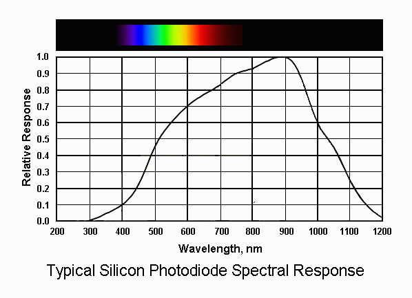

The graph above shows a problem (there are many) with what you are attempting to do.
You are working to read 400nM to 700nM which is a reasonably flat part of the curve; however the diode is very sensitive to IR and therefore thermal effects. You need an IR optical cutoff filter for wavelengths 700nM and longer.
Additionally, the design of your circuit will likely cause the diode to produce voltages from RF sources, too. You will need to carefully shield the diode and OpAmp.

mrburnette: Thank you for ideas. I'm sorry but I really know what I'm doing I mean practically, please don't tell me things like from what range I'm working on, I know that I want to know just some ideas or solutions for best results. The graph above shows a problem (there are many) with what you are attempting to do. .. ok so what are those "other many" problems? I'm using this diode: Siemens BPW21 datasheet pdf
I think I will never pass 700 nm range. And I don't have money for IR filter... that would even more reduce light intensity which I don't want. Ok still I can shield it but it won't solve main problems. Thanks you :slight_smile:
I clipped in from the datasheet for the diode the spectral response. 20% - 35% of the voltage produced falls in the 700nM or greater sensitivity range so if you are not concerned about that, neither am I.
With the cell covered with black vinyl tape, the OpAmp output should be 0 V. In reality, thermal noise and rectified RF noise (like a crystal radio) will be present but you should be able to bypass some of the RF to ground. (Looking at your breadboard design the whole thing is an RF transmitter! Take a transistor radio on the AM band if you do not believe me.) The best design would still be for everything to be shielded and electrically bypassed.
You will have to deal with the thermal noise in software (or hardware by cooling the diode), but I'm sure you already know that. Unless you reduce or eliminate heat from around all reflective surfaces, IR will screw with your readings without a filter. You could use some velvet black paint on all surfaces that face the optical window.
And while I am surely not as smart as you are (by your own admission) I do have a weebit of experience in the photonics area.
