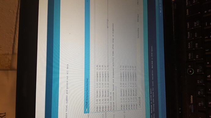

I am doing some testing trying to record how long a faucet runs while some one is in front of a sensor and soap is dispensed.
I had this code working fine for about a week but I tried moving it to a different location and setting it up. Now, when testing it (commenting out the main algorithm) to calibrate what the values should be in the main algorithm it stops printing when soap is dispensed and restarts, see attached. I haven't been able to find a solution.
Power issue?
Can you post a schematic?
The faucet part is a bit more complicated than is shown here but the faucet is reading fine. Just when the soap dispenser motor activates and outputs a voltage it stops.

When you say restarts, are you saying that the arduino reboots?
ie do the lines
Turbine Code v5
Program records faucet and dispenser activity 30sec after soap is dispensed
re-appear on your output?
If so it would indicate to me that there is an electrical fault somewhere, probably an earthing issue.
Yes, it does. I will check all of the connections that go to ground
