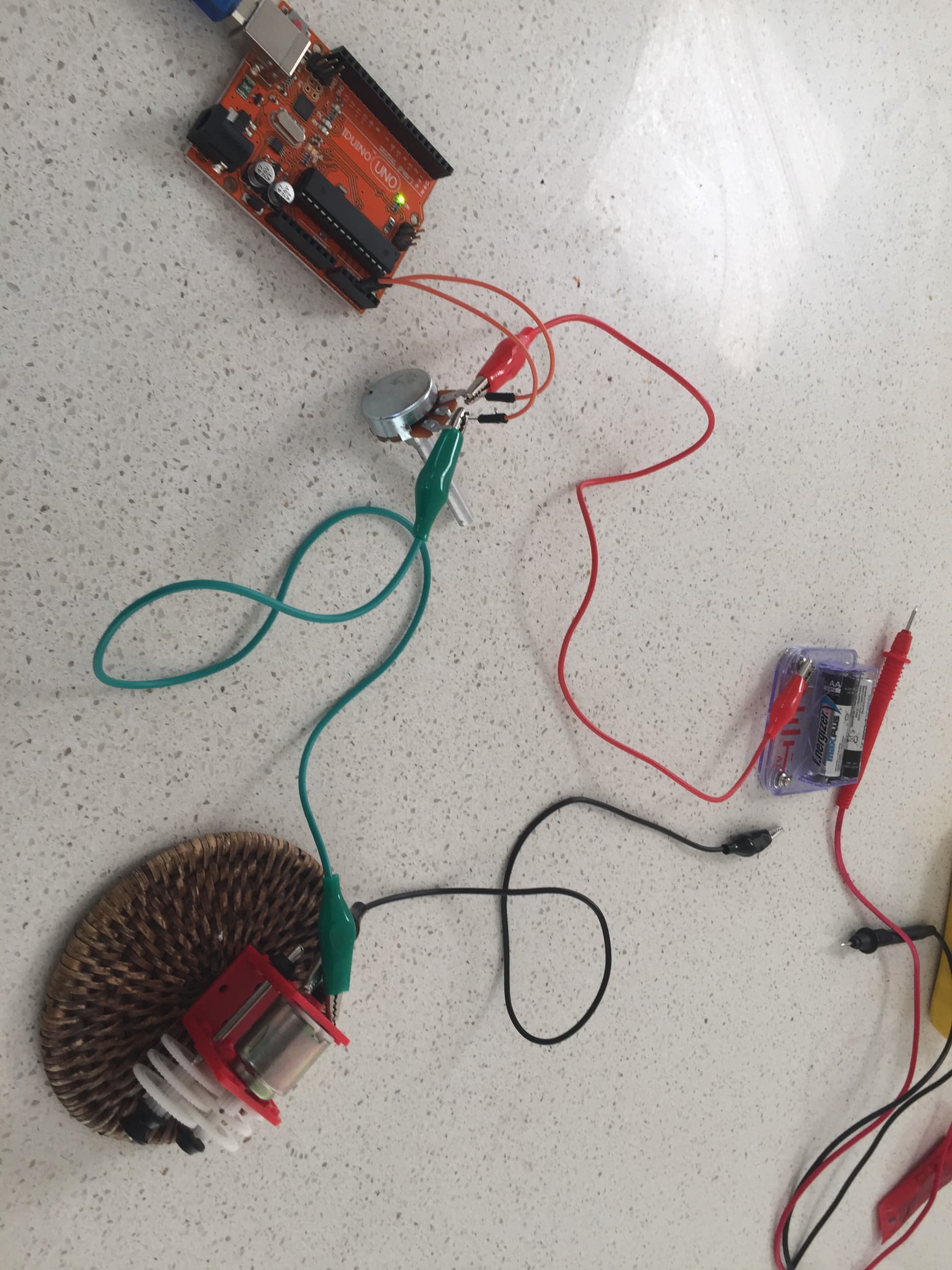

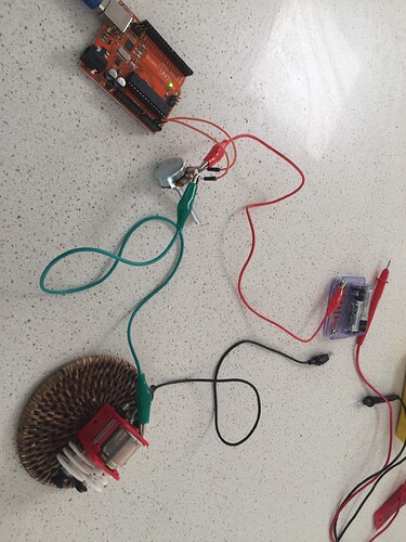

I am trying to use my arduino as an ammeter to measure current over time and output using Serial.print() by measuring voltage across a resistor and using ohms law. I have a simple circuit consisting of a battery pack, small electric motor, and 3 ohm resistor (technically a rheostat set to lowest setting), all connected in series. I also have the arduino measuring voltage across the resistor with the A2 and A3 pins. It works perfectly well, ticking once per second and outputting a voltage of 0 when the battery pack is disconnected from everything else, but as soon as I connect it, it outputs once to 3 times more and then just stops. I know the code is still looping because the light still flickers once per second, but the serial seems to be broken. If I disconnect the battery after that it still does not output, but when I close the serial output window and open it again it starts again. What really confuses me is that it seems to need to be connected for a certain amount of time to break as just connecting then disconnecting quickly has no effect but holding the connection for a few seconds breaks it. My code is below. Please help!
A picture of the circuit: currently disconnected at the negative terminal of the battery (ignore the multimeter probes)
