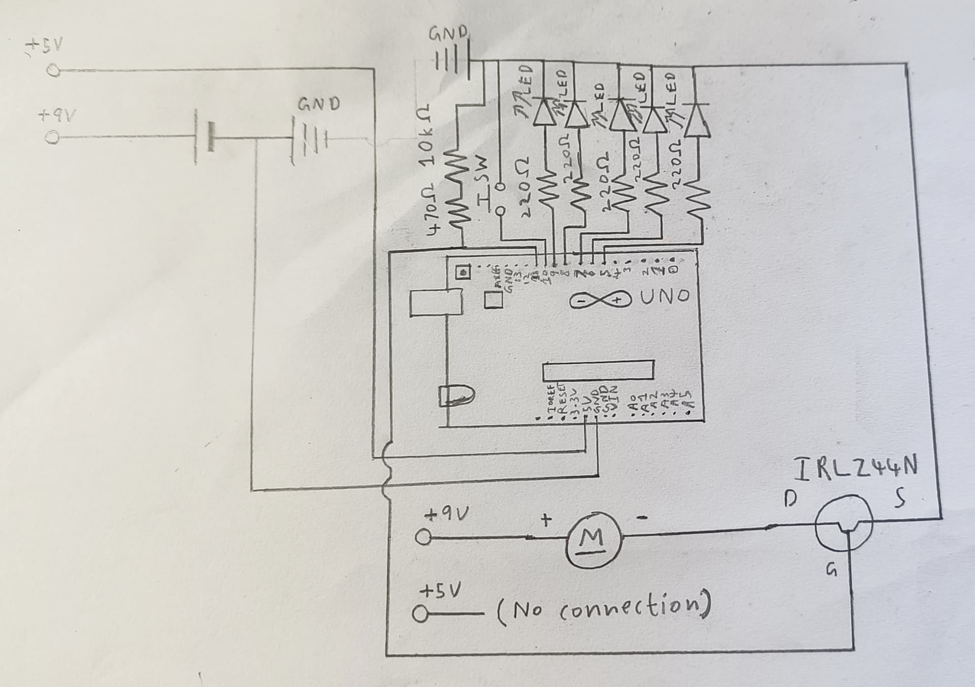

Circuit:
Hi, @shash_arduino_lover
Sorry but I edited your text to make it easier to read.

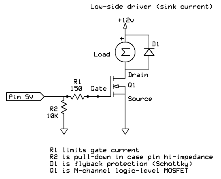

You need to fit current limit resistors for the LEDS, you cannot ensure reliable operation if you are overloading the UNO outputs to the LEDs.
Also a series resistor in the gate circuit, say 470R and a 10K resistor between Pin 11 of the UNO and gnd, so that the gate circuit is not floating when you turn your project ON.
What is your MOSFET and is it a logic level device?
Note the back EMF diode on the motor.
A proper schematic would also help.
Thanks.. Tom.... :smiley: :+1: :coffee: :australia:
Thanks. :grinning_face:
Sorry, the MOSFET transistor is an N-channel one.
But what part number, please post a schematic.
The part number of the MOSFET is TIP31C.
TIP31C is not a MOSFET, it is an NPN BJT and you are causing damage to your UNO because you have no current limit resistor in the base circuit of the BJT.
Please post some images of your project.
I tried it but it does not work.
What could be wrong?
Sorry, the MOSFET is an IRLZ44N.
Please specify the issue that you are facing. This will hep troubleshoot the problem.
First you say TIP31 now you say IRLZ44N.
Which is it?
I’m very sorry, let me just confirm that the N-channel MOSFET is an IRLZ44N, not a TIP31C.
Still does not work.

Please tell me what kind of issue you are facing. This will help us troubleshoot the problem.
Get out pen(cil), paper and ruler.
If you are keen to show your designs you need to be able to provide readable instructions and diagrams.
You have messed me up.
Your schematic does not match your diagram you show in post #1
I built the circuit in post #1 with the TIP31
I don't think you know what you are doing.
My apologies. Below, I have a legitimate hand-drawn circuit schematic for the build with all the details.
My apologies. Please check out my hand-drawn legitimate schematic in post #20.
