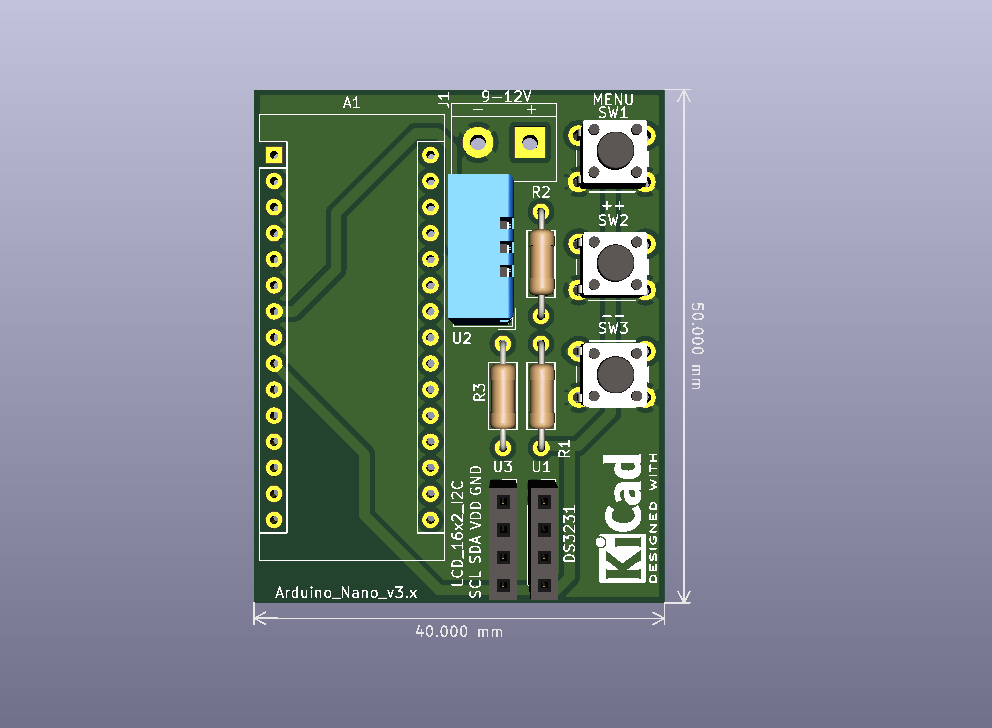

If you wish, you can later make a compact weather station PCB.
