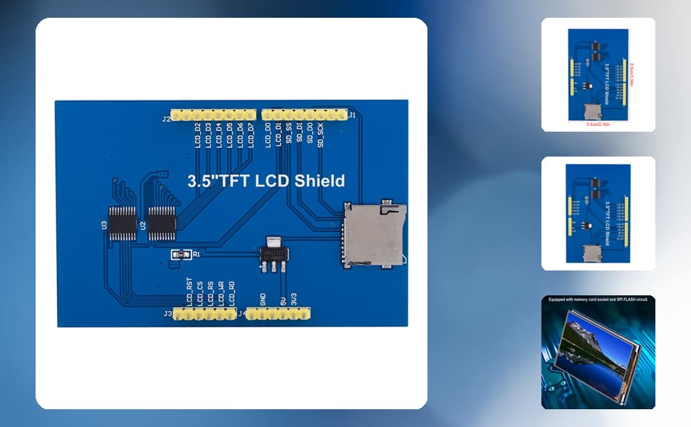

I'm wondering if this 3.5" TFT designed for MEGA 2560 will work with a Raspberry Pi. It's designed to run on 2.8-3.3v. If so, any suggestions or helpful links on how to interface it?
https://www.amazon.ca/dp/B07HFBF221?ref=ppx_yo2ov_dt_b_fed_asin_title&th=1

Please post a link to the datasheet.

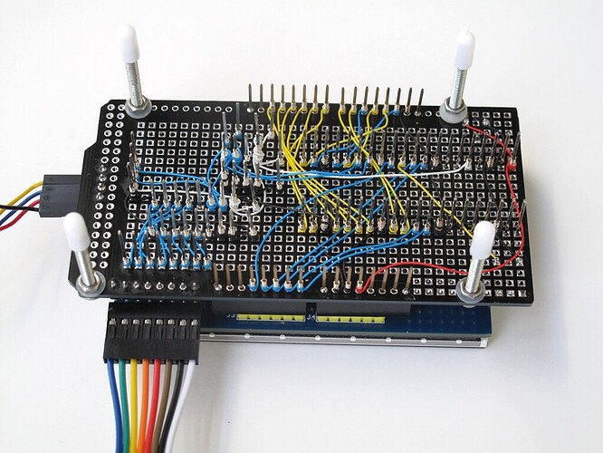

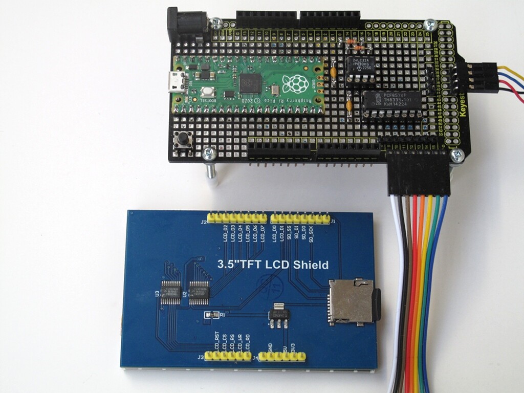

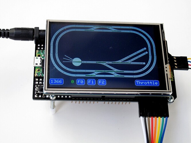

A Raspberry Pi Pico is quite do-able. You can reuse the MCUFRIEND_kbv library once you add support for however you've assigned the Pico's pins (making sure to assign the shield's two analog output pins to ADC pins on the Pico) . And you can use both the touchscreen and SD card without reinventing the wheel. Here's something I've been tinkering with and have gotten to work satisfactorily.
