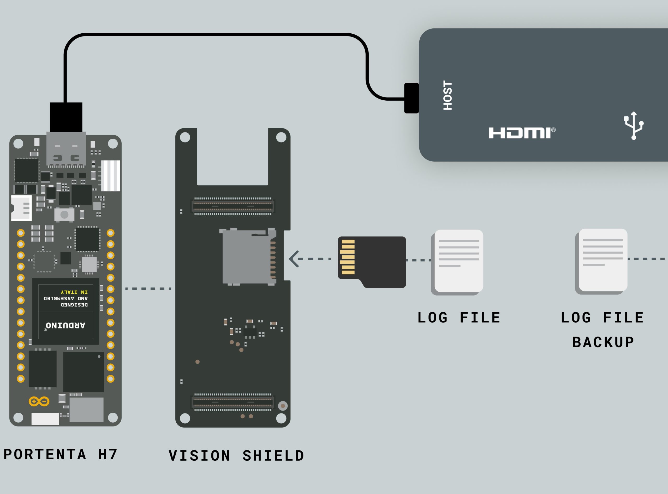

I'm very interested in using Arduino_UnifiedStorage on the GIGA. It's already available on the Portenta and this blog post says it will be coming to more platforms. When?
Has anyone tried to get it to work on the GIGA? Any successes or roadblocks?
