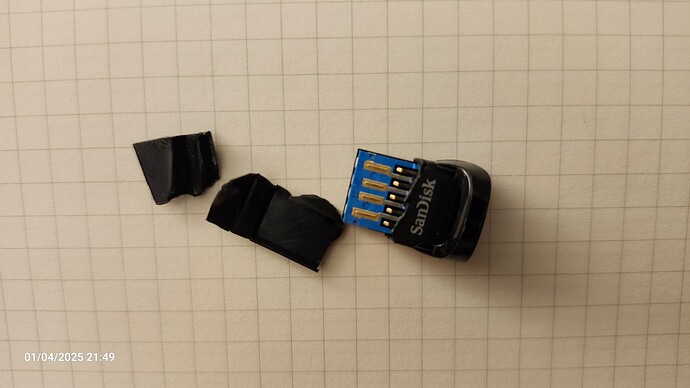

Hi @alphathinktink
With 0.3.1 of Arduino_USBHostMbed5 I'm having no stability problems with flash on USB1 however that was not always the case. I found the platform very sensitive to the drive being used and had to try a few before finding something that worked reliably.
I'm now using the SanDisk Ultra Fit and everything is stable. However, if speed is important then you may find SD faster. The best I see is 50-60KB/sec write (1KB chunks), 576KB/sec read (64KB chunks).
I also experienced blocking during writes of double-digit ms that I couldn't tolerate so moved the usb functionality to the M4 and use a shared memory area (D3) to pass data. As I'm using the usb as a black box recorder the separation was a good idea in itself.
It is telling that mbed decided not to carry over the USBhostMSD functionality from version 5 to 6. It will be interesting to see what speeds the GIGA can achieve with Zephyr OS.

Which size are you using. I want to use the exact same one.

I'm using the 32GB as that's more than sufficient for my needs

Interesting theory. I'd have to have a way to remove the drive live though so I would need to make some kind of function to close the file before removal. I am worried about the resources always being used while the file is open. Do you foresee an issue with resource management on an always open file?
I don't see (or have, as this is how I do it) a problem. The default is to flush buffs to disk on a new sector (512 bytes typically) so that's the most you'd loose on a hot pull. You'd need to detect removal/insertion and close/open as needed. Resources no problem as it's little more than a pointer.
Damn, leaving the file handle open didn't work. However, the rework and testing revealed I was using the wrong integer type for the return value from fprintf which is a signed int, I was using size_t, which is unsigned and would never test negative (for error) and would cause the board to infinitely loop on an error. The value returned from fprintf on the failure was 0xFFFFFFFF (not a very helpful error code (I think it's invalid parameter or something like that)).
This means I'll wait for those flash drives to come in, unless you have any other ideas in the meantime.

So, uh the Ultra Fit worked for me also. But thing is after a couple months heat in the Giga's port the plastic flash drive warped and then began shredding. Photo below.

If the case for the flash drive falls apart but it's all inside an enclosure, what's the issue? Does the flash drive not function anymore outside of it's casing?
It will prolly still work. Just moved on to different disk.
