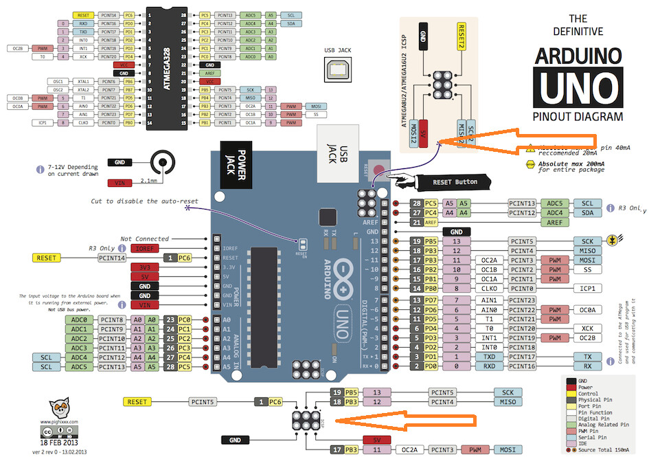

How about the VCC and GND do I have to connect them to each of the sensor to the board? I did one project where I only used 1 ultrasonic sensor and I need to connect them for it to work but the UNO does not have enough GND and 5V for three sensors, btw I'm using jumper wires, because I'm not yet used at soldering
most boards have several ground pins, e.g. the UNO has 3 - power tends to be more of a problem
you can get breakout boards with screw connectors for the UNO, MEGA, ESP32, etc, e.g.ESP32 version which makes connections much more robust
you can get two or three wires into the connectors - any more could be a problem

I'm sorry, I don't quite understand, so are you saying that connecting three VCC, TRIG, ECHO and GND (plus the switch and buzzer) to Arduino Uno is not possible without breakout boards?
PS. I forgot to add the vibrating motor that I also need to add
the three trig and echos would all be seperate pins
three grounds should be OK on a UNO
but the uno only has one 5V connector - you could use a breadboard/solderless-breadboard
you then have the switch and buzzer
A breadboard yes! Thank you!
Two other +5V pins are available on the six-pin connectors.
Thank you! will definitely use it, didn't know they were 5V
