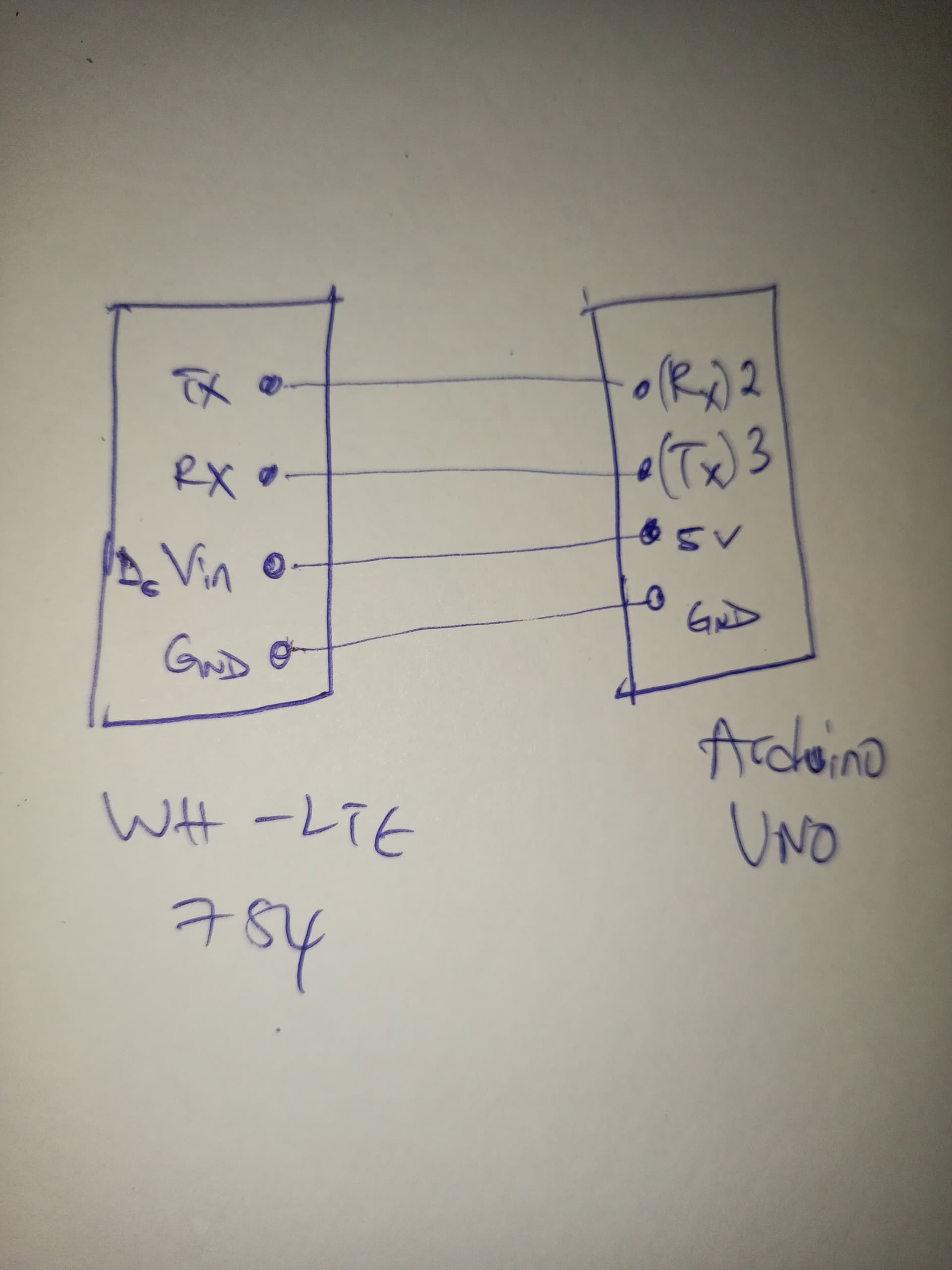

Hi guys, I have an Arduino Uno and WH-LTE-7S4 V2 Module. I am unable to receive responses to the AT commands and also un-able to get the board actively working with my Arduino Board. The Serial monitor displays the Version of the board, but nothing further.
See code and images.

@UKHeliBob indeed, many thanks. Do also note that I powered the LTE Module both seperately on 9V, and also using the Arduino board on the 5V pins, still gave me same response.
See link for datasheets, Also see wiring diagram attached.
9 volt coming from what source?
9V coming from an external power supply, able to output a maximum current of 2Amps.

@Railroader The only response I'm getting is as seen in the attachment below. I commented out the section of code below, but still got an unrelated response on Serial Monitor as attached. Which shows that the function is operational, but that the "AT" commands are not recognized/needed in order to get response currently on Serial Monitor.
