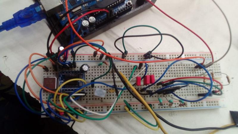

I'm trying to make an NTSC color pattern generator based on Arduino UNO full stock with stock 16mhz oscilator.

I use this diagram to connect the AD725:
The problem are the colours.
Instead of THIS,
I have this:
The problem is not with pure R pur G or pure B, the problem is when I mix for example blue and red, as you can see instead of pink, I have a full-red...
The red looks pale red.
The yellow looks pale green.
The green doesn't look... green but light blue...
The white is not white but like gray...
I loaded the game toorum quest 2.
I have the same problems...
So I think this is an issue with the AD725 RGB to PAL/NTSC encoder... I tried to change the resistors from the arduino to the AD725... No results.
I think this issue is with the PIN 12 YTRAP... But I'm not sure...
If someone had experience with the AD725 chip it can be great for hepling me there!
