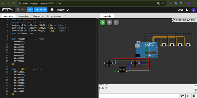

MAX7219 turning on/off the wrong LEDs
So I'm trying to make a table tennis scoreboard, I'm using an Arduino UNO R3 and 3 MAX7219. Everything works perfectly until I get to the middle one. The left MAX7219 ("player 1") shows all the images just fine, while the middle one (corresponding to sets played, where the LED on the top left side shows "player 1" has won the first set) tends to have issues with the last row of LEDs. Then, the right MAX7219 ("player 2") also has issues with LEDs, but this time it's with the last 2 rows. (I'm trying to show a "7" in the right one but the last 2 rows show different LEDs on, as if it was trying to show other number on those).
Is there any probable cause of this happening? Note I've already changed all the cables, the Arduino UNO, and the order of the MAX7219's, but it's always the middle and right one not working properly.

One suggestion though: you may want to try your sketch in the Wokwi simulator. If it show similar behavior you could conclude it’s not a hardware issue.
I've just done it. However, middle and right modules straight don't turn on, while left one works perfectly, would that mean that perhaps there's an issue in software? (Or maybe I'm just doing something wrong in the simulator? I'll include the simulator files just in case)

    [ "uno:5", "btn4:2.l", "orange", [ "v-57", "h377.6", "v105.4" ] ],
    [ "uno:GND.1", "btn1:1.r", "black", [ "v-66.6", "h268.5", "v96" ] ],
    [ "uno:GND.1", "btn2:1.r", "black", [ "v-76.2", "h364.5", "v105.6" ] ],
    [ "uno:GND.1", "btn3:1.r", "black", [ "v-85.8", "h460.5", "v115.2" ] ],
    [ "uno:GND.1", "btn4:1.r", "black", [ "v-95.4", "h556.5", "v124.8" ] ],
    [ "uno:5V", "matrix1:V+", "red", [ "v0" ] ],
    [ "uno:5V", "matrix2:V+", "red", [ "v19.7", "h-409.6", "v19.2" ] ],
    [ "uno:5V", "matrix3:V+", "red", [ "v0" ] ],
    [ "uno:GND.2", "matrix2:GND", "black", [ "v29.3", "h-409.5", "v38.4" ] ],
    [ "uno:GND.2", "matrix1:GND", "black", [ "v0" ] ],
    [ "uno:GND.2", "matrix3:GND", "black", [ "v0" ] ],
    [ "uno:11", "matrix1:DIN", "blue", [ "v0" ] ],
    [ "matrix1:DOUT", "matrix3:DIN", "blue", [ "h-25.01", "v76.8" ] ],
    [ "matrix3:DOUT", "matrix2:DIN", "blue", [ "h-34.61", "v-76.8" ] ],
    [ "uno:10", "matrix1:CS", "white", [ "v0" ] ],
    [ "uno:9", "matrix3:CS", "white", [ "v0" ] ],
    [ "uno:8", "matrix2:CS", "white", [ "v221.4", "h-403.4", "v48" ] ],
    [ "uno:12", "matrix1:CLK", "green", [ "v0" ] ],
    [ "matrix1:CLK.2", "matrix3:CLK", "green", [ "h-15.41", "v86.4" ] ],
    [ "matrix3:CLK.2", "matrix2:CLK", "green", [ "h-44.21", "v-76.8" ] ]
  "dependencies": {}
// libraries.txt
# Wokwi Library List
# See https://docs.wokwi.com/guides/libraries
LedControl
I think it's wired incorrectly, try connecting the DIn of each module to the UNO, not in cascade as you have it now.
I also simulated it, and it works correctly (or so I think because wokwi is not very mobile friendly :wink: ), but with the DIN pins connected in parallel. Your code handles each module individually to cascade them (DOut -> DIn as you have it now) the code is different.
Just connected each module's DIN to the UNO and it works perfectly now, thanks so much, I can't believe I actually struggled with it for a day or so, again thanks a lot
