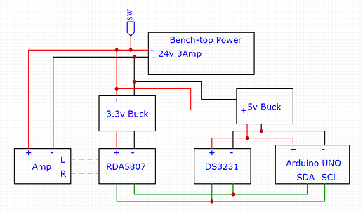

Building a FM radio with following and on the test setup, I'm powering each module as below;
  • RDA5807 - 3.3v - Buck converter powered through bench top power supply.
  • RTC DS3231 - 5v - Buck converter powered through bench top power supply.
  • Arduino UNO - 5v - Buck converter powered through bench top power supply.
  • Amplifier TDA7498 - 24v - Direct power from bench top power supply. (24v @ 3Amp)
I've recently come across that when I disconnect and reconnect the main positive line (from SW position) to 3.3v and 5v buck converters, EEPROMs in both UNO and DS3231 gets reset.
further I hear a loud POP from the amp and when reconnecting the power line, I see sparks.
Is it due to inrush current?
Any thoughts to how I could solve this?
What measurements have you made?
If you have long leads to the 24V power supply, you may be experiencing large, destructive voltage spikes when switched.
See this tutorial: Pololu - Understanding Destructive LC Voltage Spikes

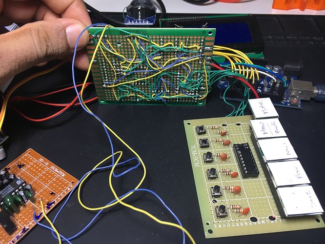

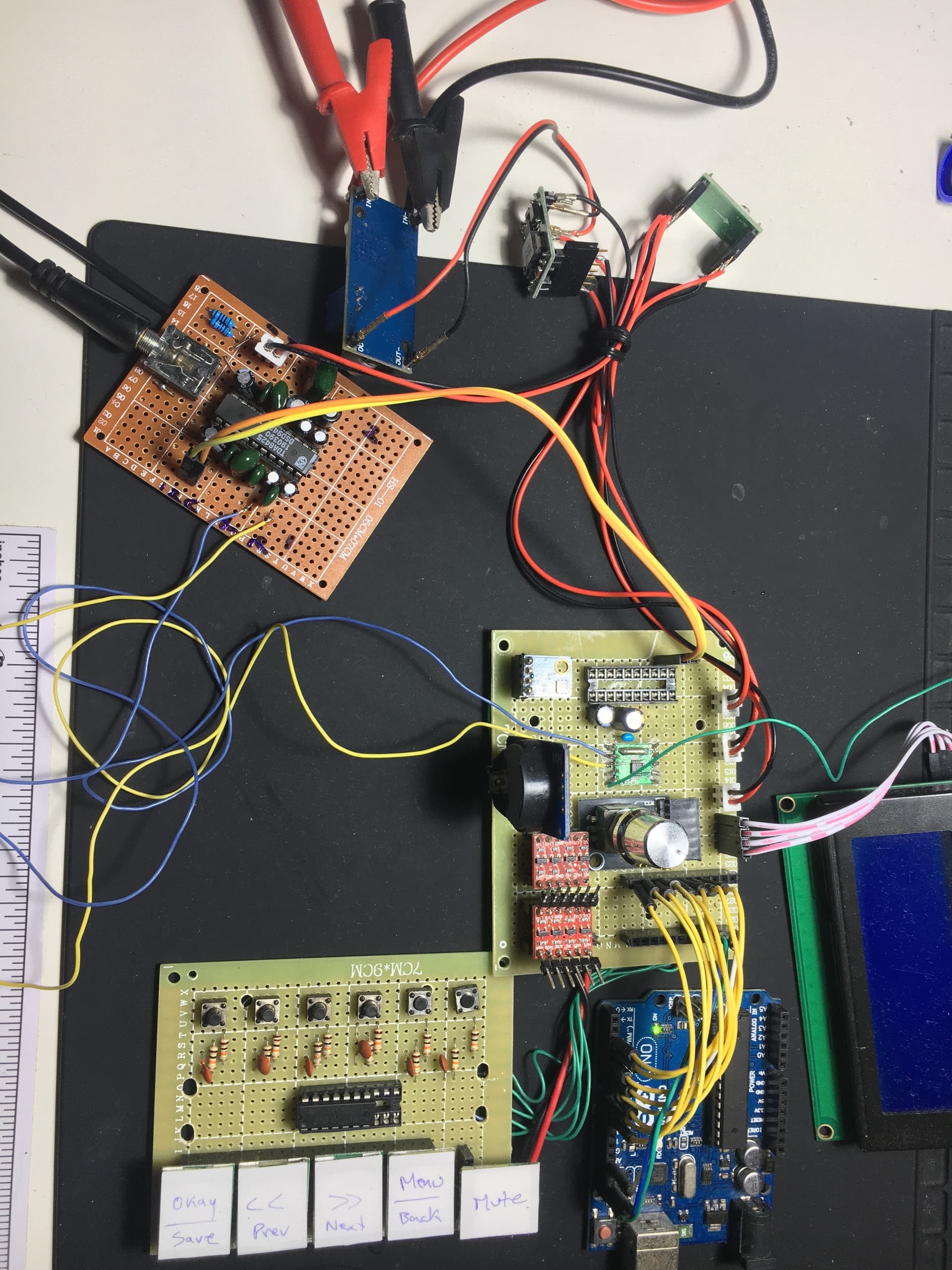

Yeah, also look out for ground loops. Please post photos of your actual wiring.
Keep in mind that breadboards are for temporary, low power logic circuits and cannot handle currents of more than a few hundred mA. The tracks tend to burn if higher.
None @aarg
Why do you think EEPROM resests? I don't believe it is possible. A SW bug seems more likely.
Yes bench power supply leads are long.

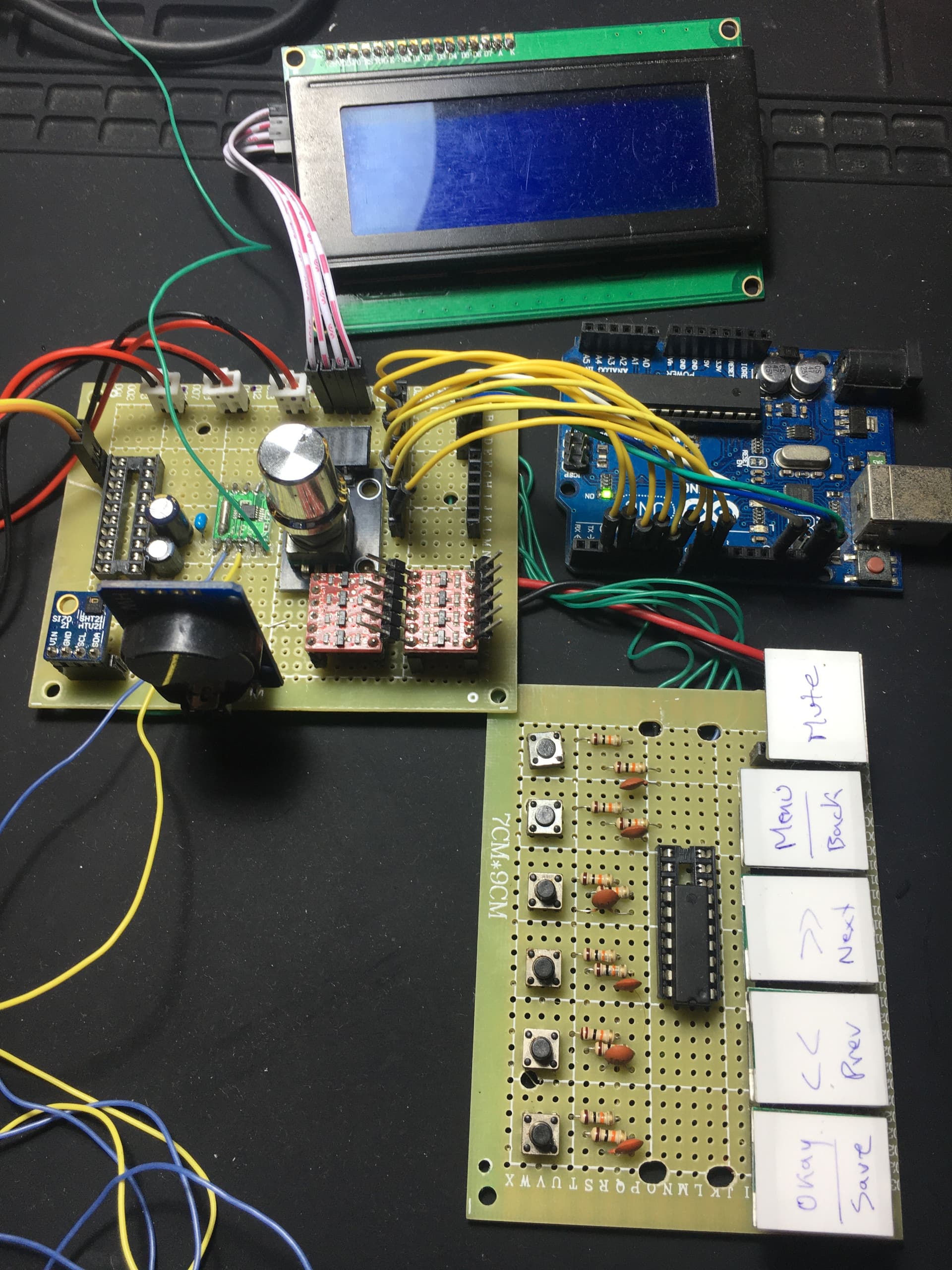

Hope these picture would help.
Google "ground loops" for several relevant articles.
The long leads in your setup are a serious problem, for several reasons: inductive voltage spikes, cross coupling, RF interference, ground loops, etc.
