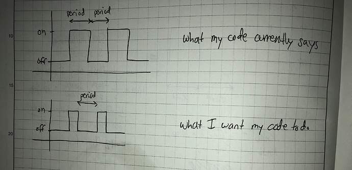

Hello, I am using an arduino uno to make a variable blinking speed strobe light. I currently have the code working, but I am looking for some help to change from 50% duty cycle. Below is the code that I have currently.

The line below currently has the light on and off for 5 seconds, but essentially what I want is to have it blink quickly on/off every 5 seconds rather than have. I found this link which is what helped me determine what I was looking for, but now I am having trouble implementing it.
myEnc.write(5000);
Any help is appreciated.

Looking at the image you posted am I correct to assume that the 'LOW' time is you period and that the 'HIGH' time is a fixed duration.

How will this "on time" affect the light when I need to reach faster speeds? I'm looking to have it blink up to 83 Hz (5000 flashes per minute) so I don't want to specify an "on time" that isn't possible at higher speeds. Maybe make "on time" = 12 milliseconds because that is the max speed possible?
in my first reply (post #2) I made an assumption which I would appreciate can confirm as correct:
"Looking at the image you posted am I correct to assume that the 'LOW' time is you period and that the 'HIGH' time is a fixed duration?"
if you want to blink at 83Hz and you set ONTIME as 12ms then you actually will be blinking at 83/2 = 41.5Hz (12ms calc period + 12ms ONTIME)
based on you reply, it look like what you want is NOT a fixed ONtime but rather a fixed DUTY CYCLE ie ONTIME = x*period, OFFTIME =(1-x)*period. where 'x' if your duty cycle.
not really complicated to code in OR you could do use AnalogWrite as suggested by surbyte.

Currently, the encoder is changing how fast the strobe blinks by decreasing "period", however, the way the code is currently written says that for there to be a minute in between flashes, the led must stay on for a minute. Essentially the time is the same value for "on" as well as "off". I need to distinguish a different variable for "on" and "off" I'm thinking in order to fix the "on-time" to the max value I need for 5000 flashes per minute while only adjusting the frequency or time in between flashes.

I think you're helping me and putting me in the right direction here! My own personal opinion is that I should have a fixed time of "on" where turning the encoder changes how frequent it blink, what do you think? I took your opinion and changed the last part of my code, but I'm running into some issues. I get it to blink to whatever speed I want using the "myEnc.write()" command, however the lower flashes I go, the harder it is to increase blinking speed (more turns on the encoder). What I want is to be able to increase by 1 flash per minute with the eventual process of two encoders (fine and coarse adjustment), but I'm struggling with the first encoder.
