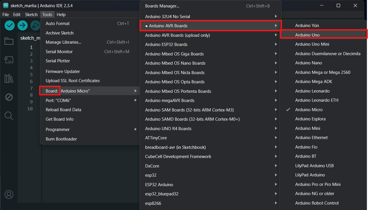

The OP has resolved the issue with a new cable, however mine is good. My Arduino Uno R3 works fine on a Win10 machine with the same cable, however on a recent install of Linux Mint (older Thinkcentre machine), my board does not show up at all. The usb ports on that machine are confirmed to work with other devices.
I searched forums like this one and applied a couple of solutions such as adding myself to the dialout group and removing the Brltty module to no avail. The Uno's leds light up though, but I can't select the board (let alone select a port) in the Ide. I'm very much a newbie in Linux and many of the responses in the forums were beyond my understanding of the workings of Linux.
I would like to resolve this as I plan on moving away from Windows within the year.
Do you mean that you have no Uno option as shown below?
Second question would be if lsusb shows the Uno? Disconnect the board, run lsusb, connect the board and run lsusb again*; observe the differences.
Last question for now is which IDE version you're using.

No I couldn't select a board and the port option was greyed out.
lsusb showed no difference whether the board was plugged in or not.
I tried to answer my own post yesterday, but it wouldn't load even though I had wifi connectivity on my tablet (it does that once in a while). The problem turned out to be the usb port I was using (and thought I had checked) was not working. I switched ports and the board instantly showed up. My apologies for the intrusion and false alarm and thank you for taking the time to respond!

Please note you should always be able to select the Uno R3 (or any other board) regardless whether the board is connected or not.
I have the latest version of the IDE. You are right, I was probably able to select a board now that I check without the board NOT plugged in (although now the port menu option is not greyed out anymore).
