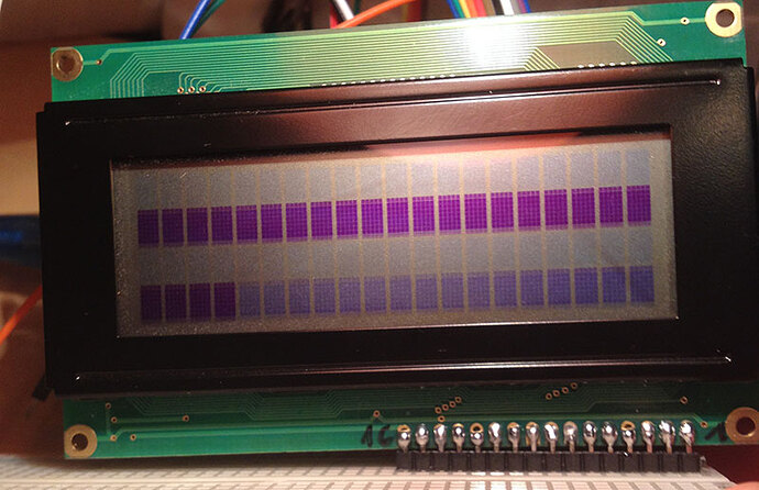

During testing with various .ino files I had display working on Line1 and Line3 (of four lines). Contrast on display was weak but I have assumed that Vo = GND was the reason since this LCD has best contrast when Vo is on negative voltage (which I don't have).
Tonight, I have completely different contrast on LCD and different among different cells on display - as on picture I have attached. Brightness is good on one line and on another on only four cells. On rest of the cells is weak as was last night.
What can be a problem ? Does this LCD has some hardware problem or I am making some mistake in software ( addressing specific position etc..). At the moment I am using LiquidCrystal_v1.0 Display.ino, but I have tried with original LiquidCrystal that comes with Arduino and it is the same.
