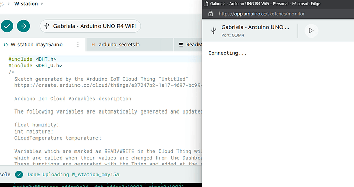

Arduino uno R4 wifi shows offline after upload latest firmware
Hello all, i am trying to make a weather station app but even after uploading my arduino shows as offline
i seen that it might be the firmware but i have the latest edition :confused:
i am also using 2.4 G as a connection
Hi @smooples.
By "offline", are you referring to the problem of Cloud Editor's Serial Monitor not connecting to COM4?
I ask because this is what your first screenshot demonstrates, but we normally use the term "offline" in this context to refer to the status of an Arduino Cloud IoT Device connection to the Arduino Cloud server, which is shown on the Thing and Device pages:
So it is not clear to me what you mean by "my arduino shows as offline".
Hello @ptillisch the second , it shows offline at the same spot as your pic ( also sorry for my english )
Thanks for the clarification. Please post your full sketch.

I should also add a note about the phenomenon of Cloud Editor's Serial Monitor feature remaining in the "Connecting..." state, as shown in the first screenshot you shared:
This is a known bug, which the Arduino Cloud developers are working to fix. I see you already found the workaround of using Arduino IDE's Serial Monitor instead, which is great. The bug in Cloud Editor's Serial Monitor is unrelated to the problem you are experiencing with the Device being in an "offline" state.

I see the problem with this sketch. The connection and communication between the Device and the Arduino Cloud servers is done when the Thing sketch calls the ArduinoCloud.update() function. You have removed that function call from your sketch, making it impossible for the Device to ever connect.
So you must add this line to the loop function of your sketch:
ArduinoCloud.update();
It might not be a problem in this specific project, but in general it is essential to design your Thing sketch code so that ArduinoCloud.update() is called frequently. The reason is that this function is what handles the syncing of your Arduino Cloud Variables between the device and the Arduino Cloud servers and your dashboards.
If the sketch code causes long intervals to occur during which ArduinoCloud.update() is not called, this will result in problems such as lags in response of the board to actions taken in the Arduino Cloud dashboard and of response of the dashboard to changes made to the Cloud Variable values by the Thing sketch program.
So adding a 10000 ms blocking delay in your loop function is generally a bit no-no for Thing sketches.
You can learn a useful technique for writing sketches that perform actions at defined intervals, while allowing the loop function to run freely and continue calling ArduinoCloud.update() frequently, from this tutorial:

Hello @ptillisch i am attaching the output
arduino_console_output.txt (1.7 MB)
Unfortunately that disproves my hypothesis. The exact same set of libraries are being used when compiling your sketch as with mine.
could it be a configuration issue ? also thanks for your time it is my first arduino project and your help really means a lot :slight_smile:
Unfortunately I don't have a clear idea of what might be causing this.

Upload the updated sketch to your board, open Serial Monitor, and then check to see whether you still see that "Fault on interrupt or bare metal(no OS) environment" error as before. If it does not occur, you will now have a "good" sketch. From there, the task will be to incrementally adjust your sketch code until you have narrowed the differences between your "good" and "bad" sketches as far as possible.
Hello @ptillisch sadly that sketch gives me error too :confused: ,
ArduinoIoTCloudTCP::begin could not read device id.
***** Arduino IoT Cloud - configuration info *****
Device ID: xxxxxxxx-xxxx-xxxx-xxxx-xxxxxxxxxxxx
MQTT Broker: iot.arduino.cc:8883
WiFi.status(): 0
Current WiFi Firmware: 0.4.1
Firmware name: "/tmp/arduino-build-F07468E3EA1A6E0F6B55D2A662225074/Untitled_may19a.ino", compiled on: May 20 2024
===== Thread stack information =====
  addr: 20007ec8    data: 20000df8
  addr: 20007ecc    data: 00004f9d
  addr: 20007ed0    data: 00000000
  addr: 20007ed4    data: 00012c49
  addr: 20007ed8    data: 0001d0b1
  addr: 20007edc    data: 40046f00
  addr: 20007ee0    data: 00000000
  addr: 20007ee4    data: 00012c87
  addr: 20007ee8    data: 0001d0b1
  addr: 20007eec    data: 0000c593
  addr: 20007ef0    data: 0001d0b1
  addr: 20007ef4    data: 0000ff9f
  addr: 20007ef8    data: 0000ff95
  addr: 20007efc    data: 00002599
=================== Registers information ====================
  R0 : 00000000  R1 : 00000358  R2 : 20003298  R3 : 00000000
  R12: 20007d73  LR : 0000b273  PC : 00000000  PSR: 400f0000
Usage fault is caused by attempts to switch to an invalid state (e.g., ARM)
Show more call stack info by run: addr2line -e "/tmp/arduino-build-F07468E3EA1A6E0F6B55D2A662225074/Untitled_may19a.ino".elf -a -f 00000000 0000b272 00004f9c 00012c48 00012c86 0000c592 0000ff9e 0000ff94
Hi @smooples looks like your board is not provisioned as a cloud device. I can see it because the device id is xxxxxxxx-xxxx-xxxx-xxxx-xxxxxxxxxxxx.
Before running any ArduinoIotCloud sketch you need to register your board so it will store its device id and can connect to the cloud.
I see from the beginning of this thread that you have already registered your board once. Can you try to delete your cloud device and create a new one?
Can you also share your thingProperties.h file ?
Hello pennam after re-registering it seems to work , thanks both :smiley: :smiley: !
