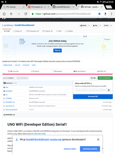

Thank you for all your focus and your time Jurai!
I think you point to UnoWifiDevEdserial1-master, being the firmware ?
I did upoad it but had already been installed.
Pls see the bottom part of the picture.
I downloaded Blync because i thought i had to , see the center of the picture.
I deleted the blynk part now as as much as possible.
Being at this stage, I end and stop at the github page I see a lot of possible links to follow.
Could you point oit more specific steps / links for me to follow up?
I like to stick to the as you advised Wifi link procedure.
tnx
