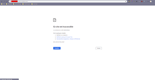

if i do http:///arduino/webserver/ i get that
and if i do http:///local/webserver/ i get that

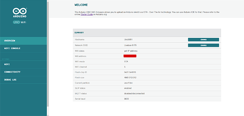

did you replace with IP?
Yes

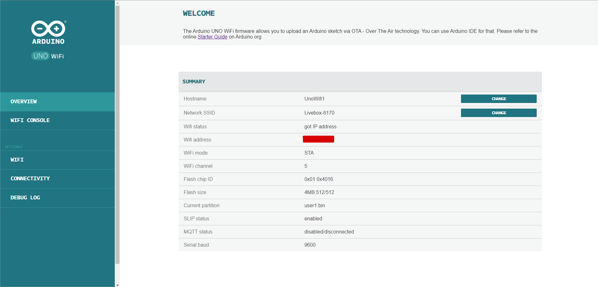

what is in debug log in web panel?
master - 2016-03-16 - 2c5e217

as I remember the request should be logged. but there is nothing, so it didn't reach the arduino.
did you use the same IP address in http:///arduino/webserver/ as for the web panel?
Yeah, i really don't understand why it doesn't work :confused:

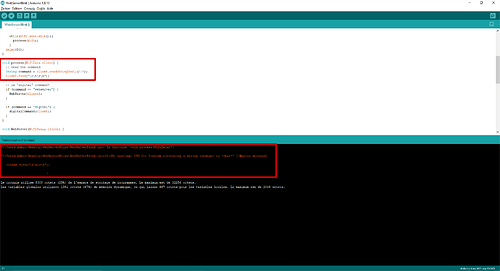

with other networking libraries I get connection reset in browser if I send the response before the request is read completly.
try to add client.find("\r\n\r\n"); after String command = client.readStringUntil('/');
Did I do wrong?
it is only a warning.
the find function has not the right parameter type since it exists, but it works.
In any case it still doesn't working :confused:
With the same code i tried it in Chrome / Firefox and from two computer but it's the same
"This site is inaccessible"

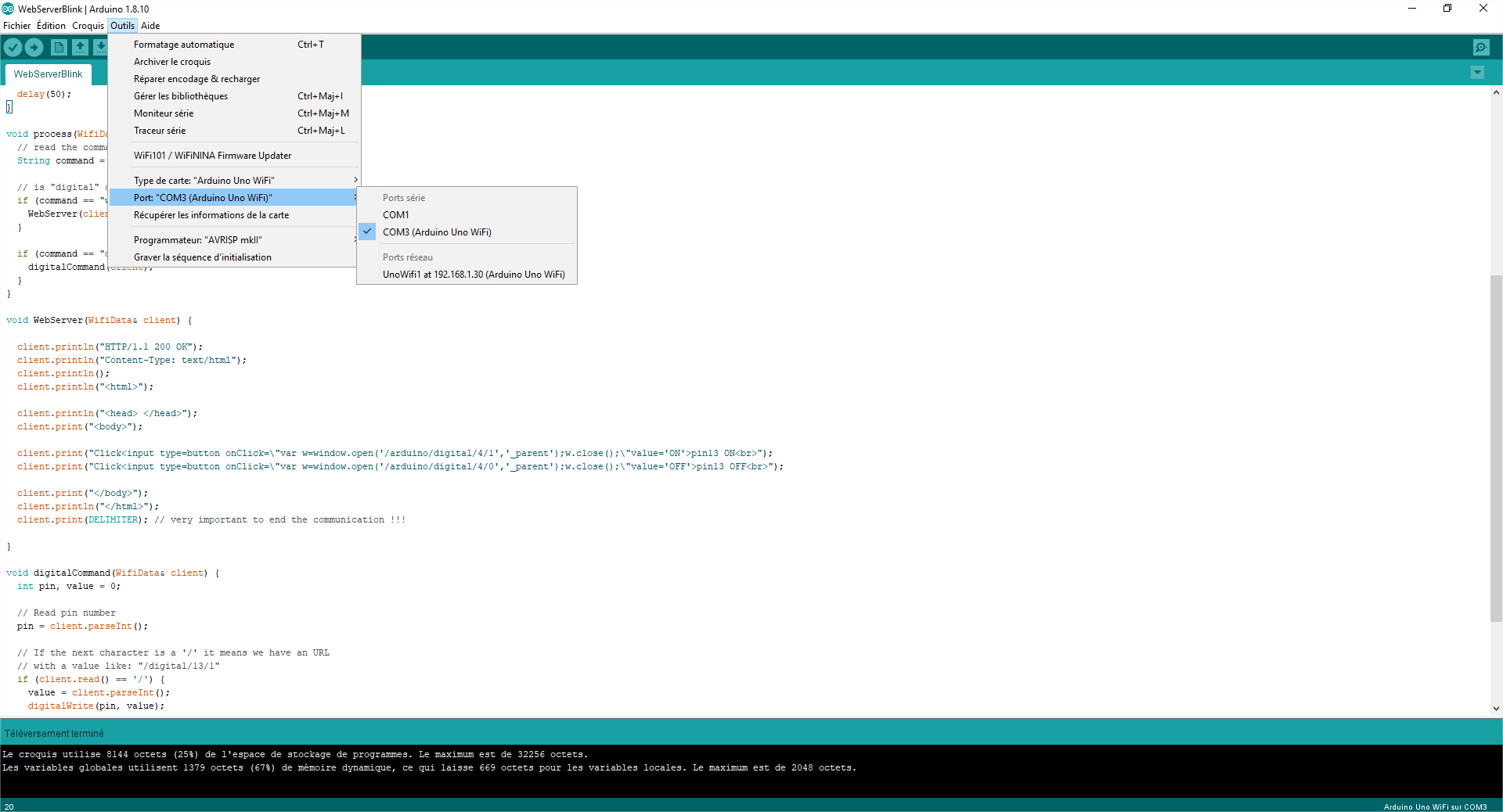

are you sure the sketch is uploaded? on screenshot it was only 'Verify'
I tried with a simple code to light up the led it's actually working so ( i tried 2/3 different code to be sure ). it was one of my assumption but for me the sketch is well upload like the other
so it simply doesn't work. I tested it and it can handle the /arduino/digital/ requests but can't it return the page. I tested all 3 versions of the factory firmware. this is a work of arduino.org.
