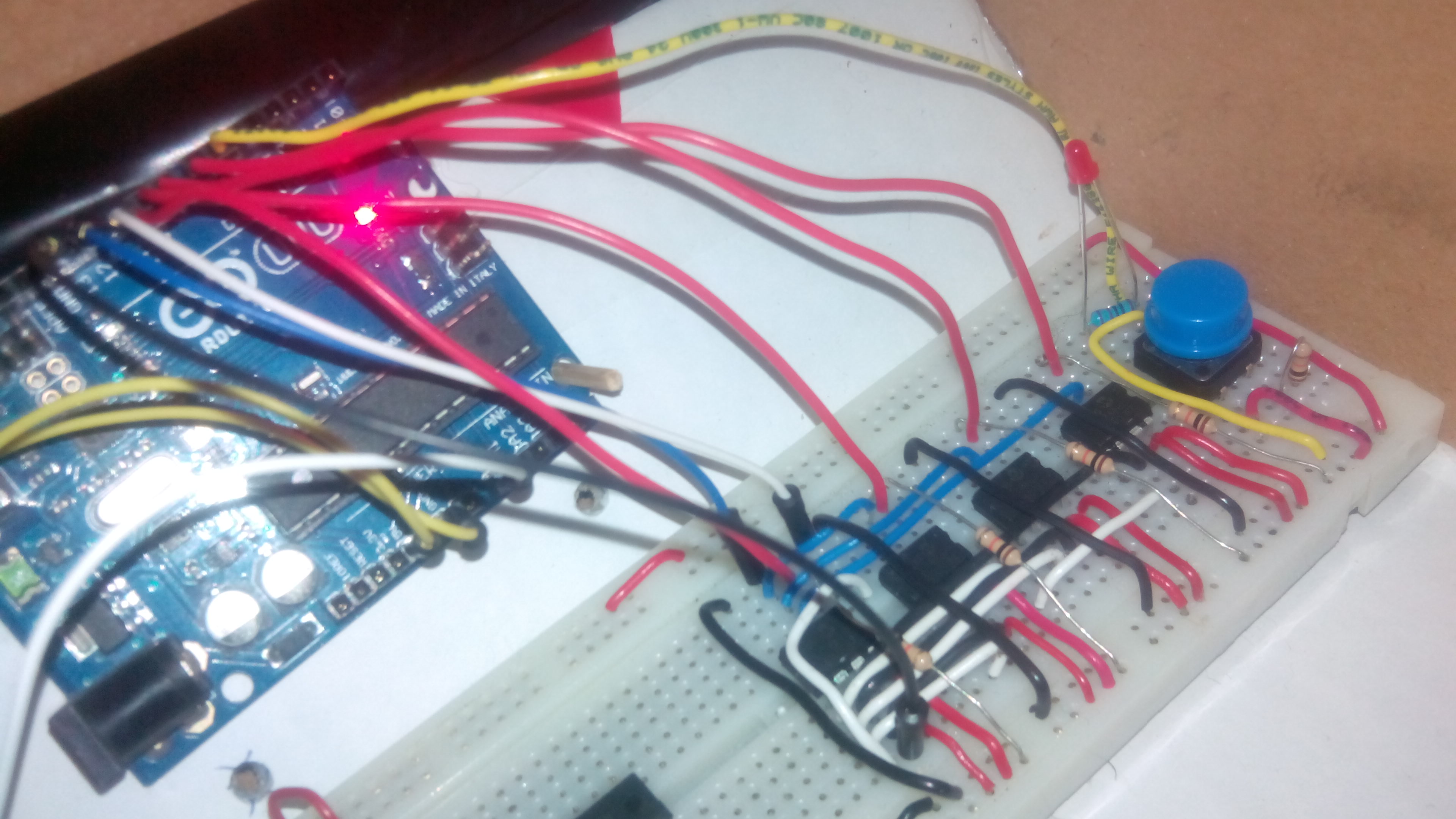

Arduino Uno with SPI (23lc1024 sram) returns always 255. First post
I have been having problems with saving data on an spi chip, 4x the 23lc1024, and was hoping if someone could help me out. ( I am using Arduino Uno)
This is the circuit and arduino connections for a SPI.
I have 4 SPI's which share all the arduino pins but all need a unique SS pin (Digital pin 10 ->7)

The read values I get are always the same , So I guess the problem lays with the writing to the chip.
I hope someone can help me out here, many thanks

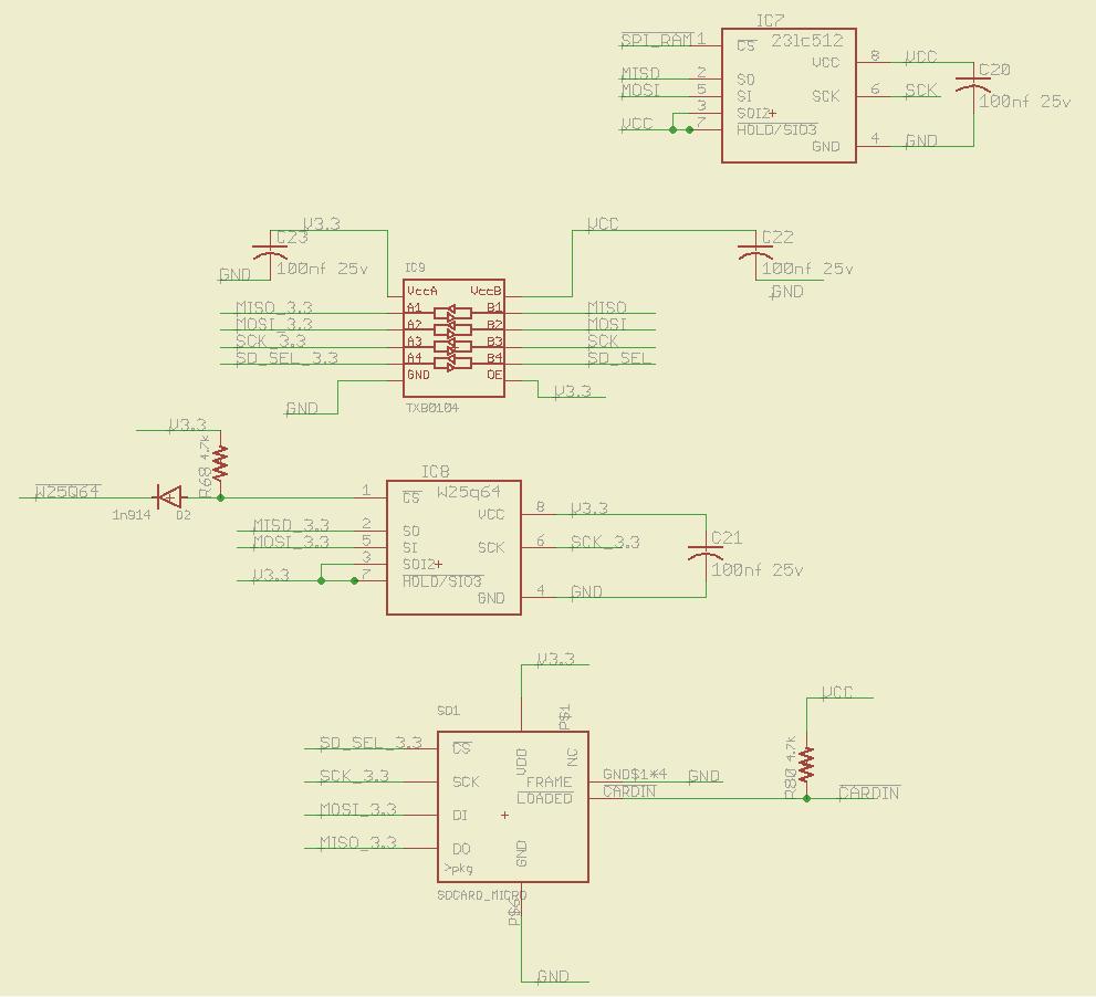

I have a 23LC512 connected to a Mega2560, I tried my code, It failed with different data values (0x00) instead of your 0xFF.
I had the SPI_MODE wrong. Attached is working code for a 23LC512.
Chuck.
p.s. here is my circuit.
spiRam.ino (3.38 KB)
spiRam.txt (1.18 KB)

Jordy,
Maybe one of them is bad. Connect them one at a time. See if they individually work.
Change the sketch so that you can individually select each RAM, use an Arduino pin as a switch that you can ground to select each RAM individually. Verify that all of the other RAM's CS pins are HIGH, Only the selected one should be low.
My Mega2560 board has a 23LC512, SDcard, ADS1118 (ADC), W25Q64FV (8MB flash) all sharing the SPI interface. I use a TX0104 as a voltage level shifter between the 5V Arduino and the 3.3V SDcard, Flash.
It all works just fine.
Unless you have a pullup on the MISO line(which you should not), The MISO line should be floating. All of the Devices on the SPI bus should triState their output unless they are selected. Verify your CS voltages and the MISO line voltage.
Attach is my working complete SPI schematic, except for the ADS1118.
Chuck.

Got it to work ! The problem was in some of the cabling I added another ground from the arduino solely for the SPI's and it worked . Thanks for the help !

I would check your circuit, do you have at least one 0.1uf cap for each 23LC512 (between VCC and Gnd).
Make sure your set the Mode opCode 0x01, to sequential.
Chuck.
I debugged the problem.
The Breadboards were not reliable enough.
I removed the SPI RAM chip from the Breadboard and connected it directly to the Arduino via Jumpers - and it worked fine.
