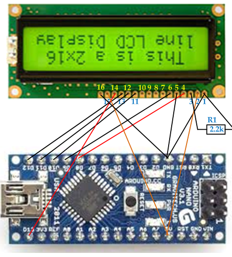

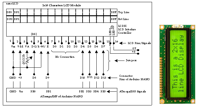

Arduino with 16×2 display
I am not able to connect 16×2 display with Arduino Nano. Please help me out on how do I connect it with Arduino Nana.
P.S - I'm a beginner.

Check if the following diagrams are helpful for you to make a connection between your NANO and the standard LCD (not I2C LCD with a small board at the back).
