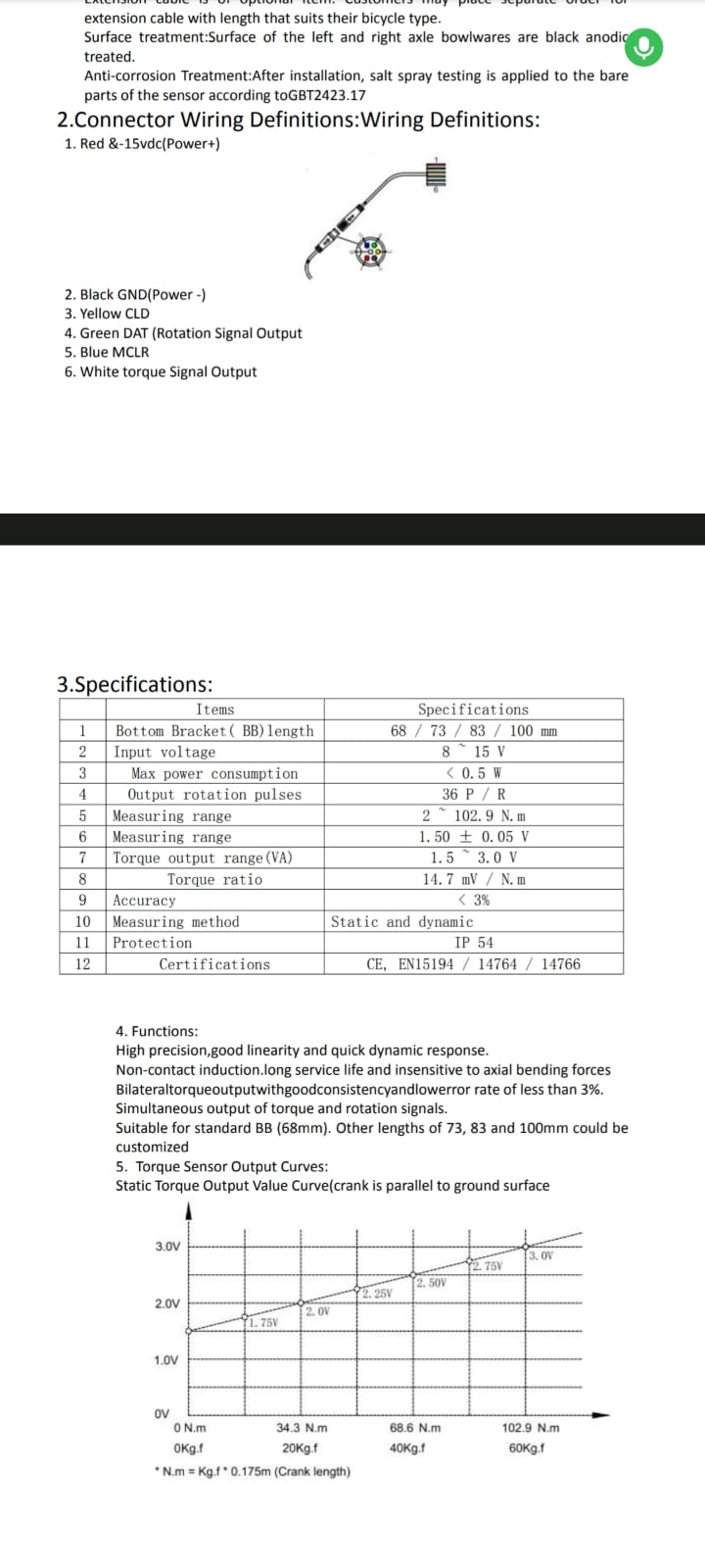

I have attached a snippet of the torque sensor datasheet which clearly shows signal voltage should vary from 1.5V to 3.3 V, but the voltage I'm getting at all pins of the torque sensor are 3.3V (Except power pin which I'm getting 12V as expected)

If, in fact, the currently linked datasheet is applicable, then you should indeed be getting 1.5v (no load) to 3.3v (full load) on the analog torque output pin. So maybe it is defective.

Only to be sure you are using the white pin as the output.
Yes, white pin and also tried green pin (rotation signal).
It doesn't say what pins 3 and 5 are used for. Maybe they're electrically isolated or need to be energized somehow??? On your DMM what do you get between 4 and 3 or 4 and 5?

Since all pins have 3.3V, the potential difference is 0V between any 2 pins
Is MCLR a reset signal?
Is CLD an enable?

Shashank, have you contacted the manufacturer for additional installation details? Do you have a large value resistor(s) you could use to connect either/both pins to ground?
Yes, I've contacted the manufacturer but no luck. Once they said it's using UART15384 bps protocol (completely opposite to what datasheet says) then they said they'll look further into it when asked more into detail.
