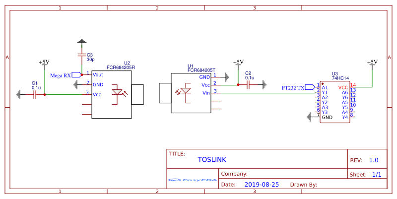

These are the waveforms on the pins 2 and 3 of the Nano when I just press the "Send" button on the serial monitor, without typing anything (yellow is TX, going into a MOSFET, which ties the TOSLINK transmitter's Vin to ground, blue is the TOSLINK receiver's output):
Everytime I send something I get three '␦' characters, then as much '␦' characters as long the string I sent is.
I heard that these TOSLINK components works over 100kHz, but if I have such a nice signal at 9600bps then why can't I read the characters I just sent? I tried higher baudrates with the same results...
Any ideas would be appreciated!

SmileXS4:
I tried sending from a FT232 module to a Mega and replaced the MOSFET with a level shifter IC. Under 57600 bps now works! I'm surprised because I thought they only work over 100kHz.
You didn't post a schematic, so we can't give any feedback on your MOSFET circuit or this mystery "level shifter IC". What was it you thought only worked over 100KHz?

Post that schematic!
Well, it looks like these TOSLINK components are really designed for over 100kHz! I don't know why they worked at 9600 bps with the 74HC14 IC, however they work now without it even at 2M bps!
Here's the schematic which contains the 74HC14 IC that I no longer use:
Thank you for the suggestions again, PaulRB! I'll be back if some new problems occur or if I finish this part of my project. :slight_smile:
