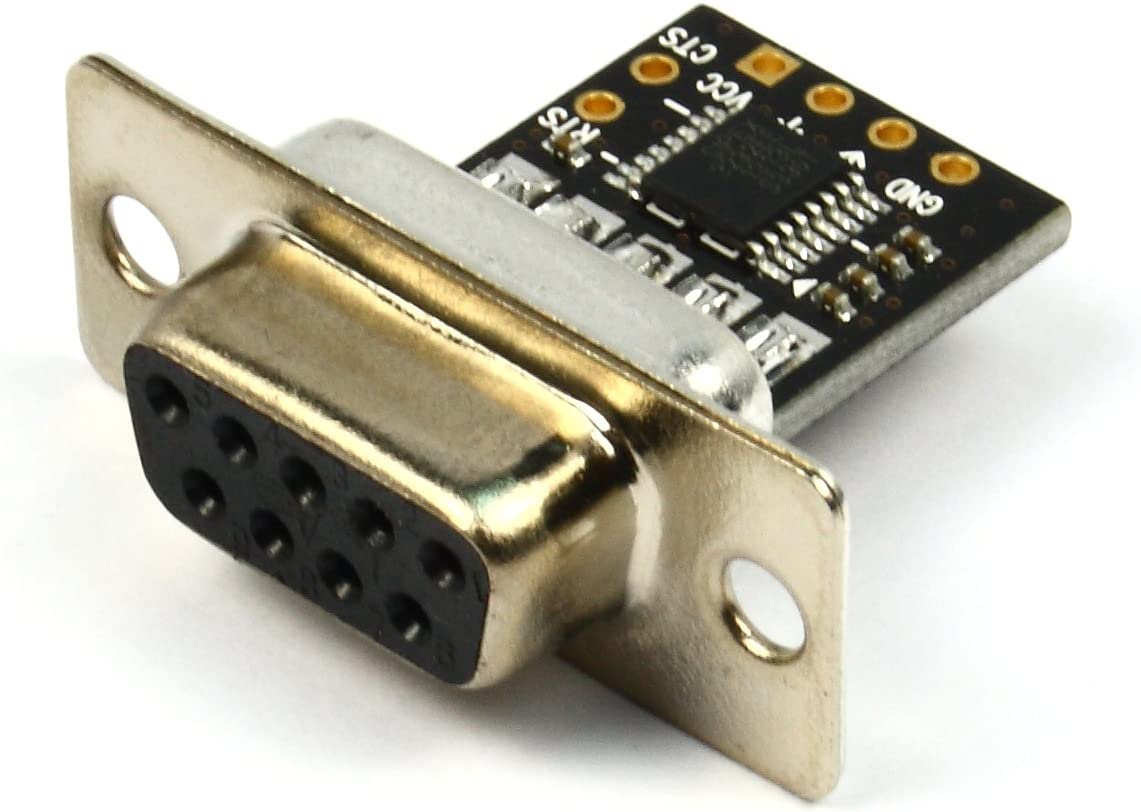

I took a peek, and only found USB to serial FTDI cables.
What I need is something to connect the Arduino RX/TX pins to a device that does not have USB, just an RS323 port.
Is there such an adapter to convert 0/+5 to -12/+12 directly?
If not, I'll have to make one myself.
This should do the trick:
Thanks to all that helped!
Bob8K:
http://www.amazon.fr/Convertisseur-RS232 vers-Ultra-Compact-DB9 femelle/dp/B00OPTOKI0/ref=sr_1_90?ie=UTF8&qid=1455010655&sr=8-90&keywords=ftdi
Yep, looks like it.
