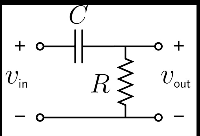

Based on my "research", the best solution is to use hardware (i.e. RC) to condition the ADC input signal for the desired (high and low) bandpass. The next best option is to pad the "offending" bins with mean FFT readings, and the last resort is padding them with zeros.
So first, a hardware high-pass filter question: what R and C values should I use on the Seed XIAO 52840:
  • Nordic nRF52840, ARM® Cortex®-M4 32-bit processor with FPU, 64 MHz
  • ADC sampling with input impedance between 6M Ohm-10M Ohm, max. sampling rate 250 kHhz capability, 12 bits max, set at 2.4V Internal Reference
The input signal is:
  • active op am amplified filtered AC sine wave (DC removed) between 0-2.4V, resting at 0-60mV, FFT reading triggered above 1V and then the measured input signal length period is between 40us and 1ms at a relatively narrow frequency band that is located anywhere between 500hz to 25Khz.
  • do not know how many mA's on the input line, but could measure if necessary
In my case, I would like to measure FFT above 500Hz and below 25kHz (in the most desirable case 500Hz-100Khz).
For the high-pass RC filter, want to read only above 500 Hz, so I calculated: 1K for R and 300nF for C. I am wondering if the 1K resistance would weaken the input signal too much?

The RC filter you suggest has a -3dB attenuation at 500 Hz. If the problem is 50 Hz calculate the filter for 100~200 Hz and test it (you can change resistors easily, dont know why you ask instead of trying it). You should take into account the output impedance of your source.

Ok.
So, you already have a filtered signal.
Those 2 op amps are band pass filters.
I would never choose this configuration, 1 2nd order low pass and 1 2nd order high pass filter worked better for me.
You can easily simulate that circuit and choose R and C for each op amp (they should be the same values). You dont need to add any extra circuitry.
The change of the ratio and the sampling frequency is due to aliasing.
Fiind a sampling frequency that works. It should be below those 35khz.

I also tried some high-pass hardware filters, but no avail.
Tried:
100 Ohm and 2.3uF (686 Hz cutoff)
470 Ohm and 2.3 uF (145 Hz cutoff)
They attenuated the signal by about 50% and 30%, but the FFT still picked up the 60 Hz interference' harmonics. These filters also blocked all higher frequency signals, at least at the 3 Khz level and below. Which does not make sense. (This filter taps into C36 capacitor on the two op amp circuit and then goes to pin A0 of my MCU)
Memo for self: I need to measure input and output impedance for the radar device and my MCU board after I read up on this topic.
You are applying a bipolar signal to the ADC input. That can not only damage the nRF52 but will create all kinds of unwanted harmonics.
I would concentrate on fixing your hardware problems and worry about the FFT later.

As I already pointed out that is a problem as that voltage goes negative.
I believe that the signal going to AIN0 is AC at capacitor C36, as I could not measure it with a multimeter set on DC. I was able to measure the DC signal at 2.5V right after the second op amp, but when reaching C36 had to switch to AC. On the oscope it shows as a 0-60mV slightly noisy signal, and when the sensor reads an object, it goes up to 2.4V in a sine wave (see posted oscope picture).
EDIT: I see what you mean. It goes down to negative 640mV. But I get FFT readings indicating interference even with my MCU board only connected via the USB cable to my laptop. Nothing is connected to the the radar device
EDIT: so my question is: I do not have the firmware code for the radar device, but I am using a near identical MCU setup. So the radar device must be dealing with the negative input via software, because there are no more passive components between C36 and the ADC pin. But the issue is not the FFT readings on the radar device, but on my MCU board. The FFT readings showing 60 Hz harmonics show up also when the two are NOT connected.
I see that is has a differential input that can probably handle negative voltages, your ADC cannot.
