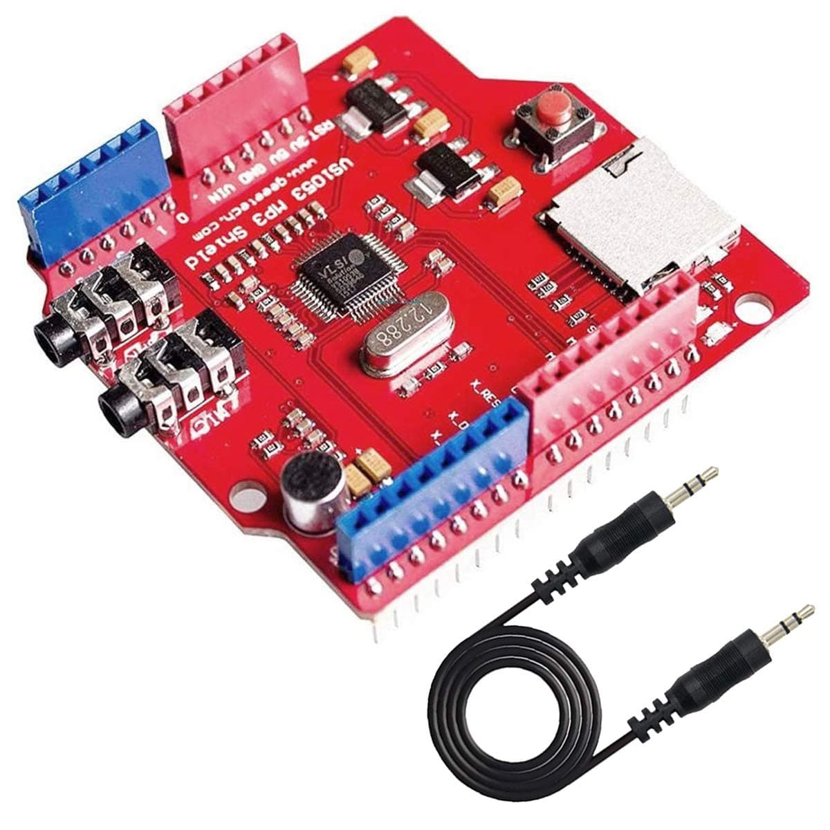

Hello,
I try to make a music player with Arduino R4 WiFi and a VS1053 board.
I can't compilate the sketch : #include "wiring_private.h" is the problem.
I search in Internet a solution and it seams that R4 is not compatible with the library Adafruit_VS1053.
Someone knows if it's right and if I have to change my R4 to an R3 ?
Thanks'
Solution : Thank you @ptillish
For who is interessted, the solution is :
Download the good library here : GitHub - motazEmad/Adafruit_VS1053_Library: This is a Arduino library for the Adafruit VS1053 Codec Breakout and Music Maker Shields
If you use SdFat to access the datas on the SDCard, edit Adafruit_VS1053.h and comment some lines like this :
//#if defined(PREFER_SDFAT_LIBRARY)
#include <SdFat.h>
extern SdFat SD;
//#else
//#include <SD.h>
//#endif
There is a pull request against the Adafruit library.

Hello Sir,
I send you a message because I have a problem of compatibility between a vs1053 board and an Arduino R4 Wifi.
I try to find a solution in internet and forum and it seams that Uno R4 is not compatible with the Adafruit_VS1053.h library. The problem is signaled for a long time here (compatibility with Arduino UNO R4 Wifi board by motazEmad · Pull Request #95 · adafruit/Adafruit_VS1053_Library · GitHub) and nothing change.
As I develop a product, I want to know if the problem will be solved or not. If he don't, I have to search a solution without R4.
Thank you for your answer.

Hello,
Thanks' for the response.
I'm in linux and I can't uninstall as you tell. I don't have uninstall in the IDE, I have to detete the folder. I think it's all right, no ?
With the new paquage, the #include "wiring_private.h" error desappear. Cool !!!
But I have a problem with SdFat.h. It works with SD.h, but not with SdFat.
I try 2 libraries : the greiman one (GitHub - greiman/SdFat: Arduino FAT16/FAT32 exFAT Library) and the Adafruit one.
It's the same problem.
Do you know if it's possible to access the datas with SdFat ?
Thank you.

Ok, I've a new IDE ! Nice !!! Thanks' :wink:
All the libraries are clean.
My project is, with an app, to acces to the midi files who are in the SDCard on my VS1053, select a file and play it.
I have an Arduino R4 WiFi and a VS1053. This one :
I can acces to the files list in BLE on my app. I've to use SdFat because the names of files are some times long (more than 8 caracters).

I solve a part of my problem. In Adafruit_VS1053.h, I comment some lines. It's better.

Great work on troubleshooting the cause of the errors! Are you still experiencing a compilation error? If so, please post the updated compilation output, just as you did in post #9.
Yes I have some errors, it's certainly because I code with my feet :wink:
But there are less !!! So cool !
