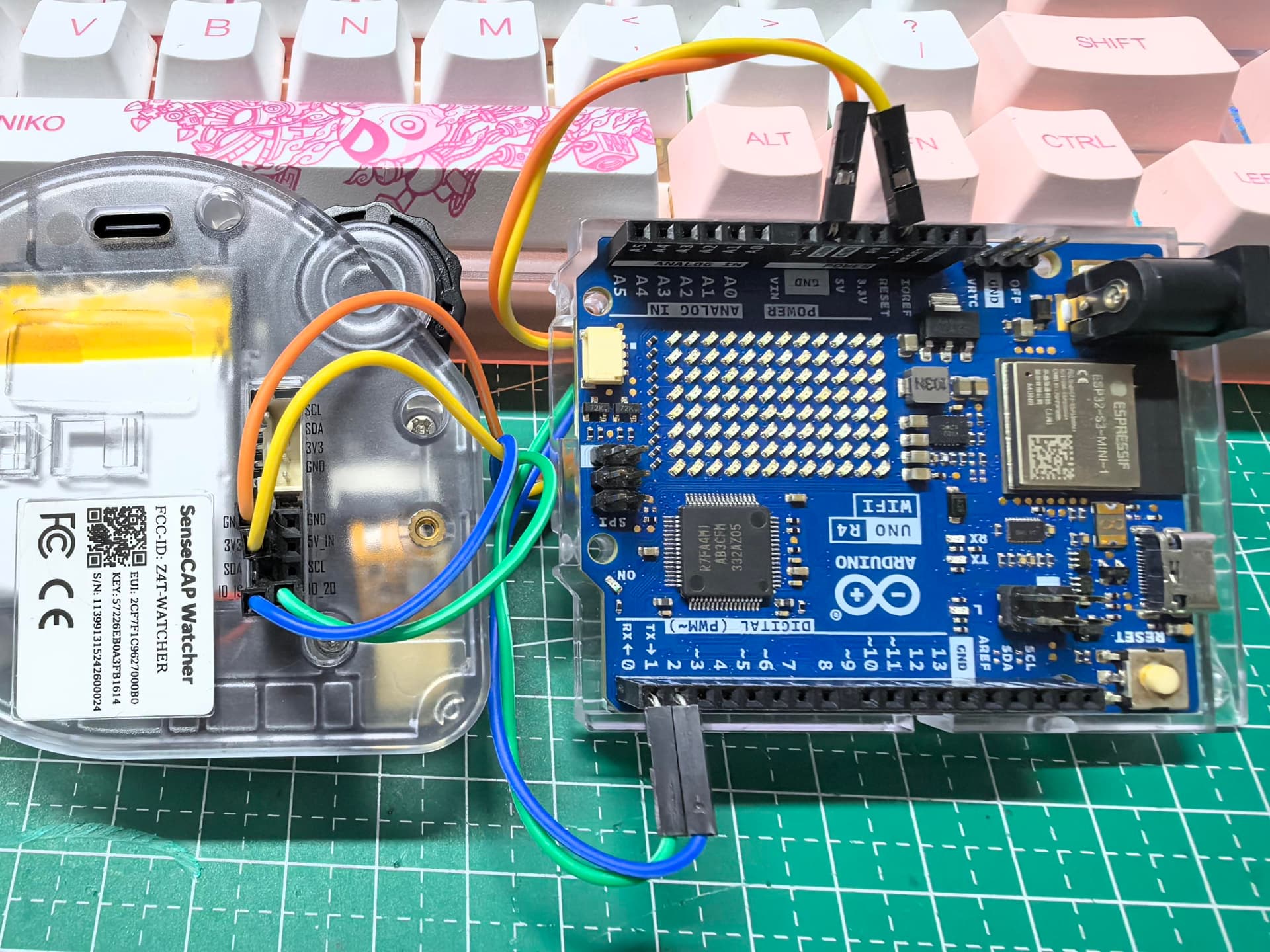

Now, I want to take things to the next level by integrating it with the SenseCAP Watcher. For those who aren't familiar, SenseCAP Watcher is an AI assistant that can recognize models and transmit the results via UART. It's a really cool device that I think has a lot of potential.
However, I've run into a bit of a problem. As you can see form the picture, the wiring is not very aesthetically pleasing. I'm hoping to minimize the number of wires to make the integration cleaner and more streamlined.
So, here are my questions:
  1. If I only need to receive data form the Watcher, can I leave the TX wire form the Arduino unconnected?
  2. If the Arduino is powering the Watcher, can I get away with just connecting the 3.3V power line and omit the GND wire?
    Ideally, I'd like to use just two wires for this setup. Is that possible?
    I would greatly appreciate any insights, advice, or experiences you can share.
  1. Yes, if you are certain that the Watcher does not require any input from Arduino TX.
  2. No, a shared ground connection is absolutely required.

Thanks for the quick reply. I think I now know why I'm not getting messages, probably because there is no shared ground.
Incidentally, I noticed that the Watcher has a 5V input pin on it, and a 3.3v pin, so I guess it doesn't have a 5V output, only a 3.3V output. I'm wondering if I connect both the Arduino and the Watcher, and they are both powered, and have DuPont wires connecting the Arduino to the Watcher, will they burn out? Is the power cable always not connectable?
You need to fully understand the power requirements before you start making any connections. A mistake could burn out both the Arduino and the Watcher.
Watcher is Esp32-s3 with Ai-board,camera and display. It's 3.3V MCU and it's data lines are not compatible with 5V arduino boards. You could simplify your life using some other arduino that has 3.3V MCU. Otherwise you need level converter on serial line.
Ideally you power arduino and Watcher separately and connect them only with GND and RX/TX. Watcher 5V pin can be used as output or input, 3.3V as output.
