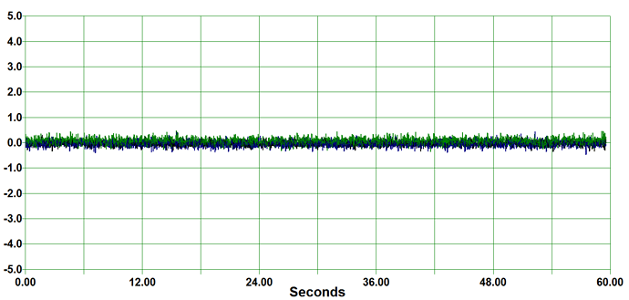

Are these Gyroscope readings correct?
Hi, i am trying to calibrate my MPU-6050 and GY-271 (magnetometer) for use in an AHRS.
Here is the code i used to find the offsets for the MPU-6050:

I uploaded the code and it gave me some offsets for the accelerometer and gyroscope, which i then used in my own code here:

Here are the offset gyroscope readings:

Do these look correct? I know that the offset gyro readings should about 0 but in some instances the readings are going all the way up to +-0.6. Is this normal? Or did i do something wrong?
I have attached the graph plots of the offset gyroscope readings along with the non-offset gyroscope readings.
Well it looks like the Z is miscalibrated - but what are the units?
What is the rms noise spec in those units? Is the variability higher than you would expect
from the noise specs?
[ Why not calculate the mean and standard deviation and print those out too ]
The units are angular velocity (degrees/second). The readings i posted are when the MPU-6050 was completely still.
Sorry, i'm not that familiar with RMS noise specs.
Do you mean the mean and standard deviation of a sample of the offset readings or the non-offset readings?
Here is the datasheet for the module i'm using in case you want it: https://www.invensense.com/wp-content/uploads/2015/02/MPU-6000-Register-Map1.pdf
Also, i edited the original post to include graph plots of the readings in case you wanted to have a look at that. :slight_smile:
mean/sd of the corrected readings - the mean ought to be close to zero if calibration worked, the sd should
match the spec's of the gyro from the datasheet.
Offhand those deg/s readings seem reasonable - you get a lot of noise from MEMS sensors, but once its
integrated/low-pass-filtered that's much less of a problem.
The graphs look like its basically Gaussian noise, no big spikes or transients.
I took a sample of 200 readings and the found that the population standard deviation is 0.24673806213. The mean i found to be -0.17535776614.
Just by looking at that graph plot, the z axis (in green) could definitely be miscalibrated. However, the graph plot of the non-calibrated readings also have the same issue. It seems like the calibration hasn't changed much on the z-axis readings. Either my offsets are off or maybe this is just an issue with the sensor itself?
EDIT: I realized that the plot for the non-offset gyroscope readings was incorrect and fixed it.
It looks like i seemed to have fixed the issue. I have attached the graph plot of the new values to this post.
I fixed it by uploading and running the auto-calibration code but instead of taking the offset values and using them in my code like it said in the serial monitor:

This time i did not use the offset values in my code and just started readings values instead, this is what came up:

An offset of 4 seems to be the sweetspot. However, i still feel i little but unsure about the standard deviation because i don't know as much about it. Are these standard deviation values good enough?
I have also attached a graph plot of the gyroscope with an offset value of 4 while it was completely stationary (the graph with an offset of 5 is pretty much identical).
The data sheet tells you what to expect for noise.
For the gyro, if the output is scaled to degrees/second, then you expect a standard deviation from the mean of about 0.05 degrees/second:
GYROSCOPE NOISE PERFORMANCE FS_SEL=0
Total RMS Noise DLPFCFG=2 (100Hz) 0.05 º/s-rms
So do you think this large standard deviation is a result of sensor bias (and maybe temperature?? At the time of testing it was roughly 25-30 C) and that there is nothing that can be done to reduce this?
Can i not use a magnetometer to reduce the bias of the gyroscope (and maybe accelerometer)?
