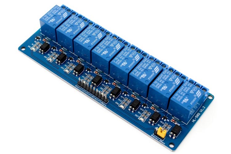

I am having issues with my Arduinos (Mega 2560 & Uno R3) and they are not outputting their rated amps.

As you can see, its super basic code, but my multimeter is reading 0.7mA output when the pin is on, with both boards. the datasheet says it should be outputting 40.00mA per I/O pin.
I think it may be an issue with my code, but I think I could also be something else I'm missing as I am new to this.
Any help would be great :slight_smile:

What are you using as the load on the pins when you measure the current ?
Are you familiar with Ohms Law ?
What's the load on the pin? Just because a pin is able to give pinAmps does not mean the pin will output max pinAmps all the time. The current drawn is dependent upon the load requirements. It comes back to
The result is the same, with or without load. The intended load is a 24v relay but my issue is that it isn't being triggered as the .7mA is too low.
How are you measuring the current without a load attached ?
What is the resistance of the relay coil ?
Which 2 pins on the relay are connected to its coil ?
Please don't tell me that you have got the multimeter on a current range when using that circuit
Double check. Chances are good you are actually measuring 0.07A or 70mA. The data sheet doesn't say "it should be outputting 40.00mA". It says 40mA is the maximum that you can draw without damaging the pin. So you are either measuring 70mA, or a damaged pin measuring 0.7mA.
The sensible place to put the probe would have been in series with the line to the relay board, which would tell you the actual current into the relay board. Instead you short circuited the pin.
If you are powering a bare relay, don't. You need an interface circuit, that is why people use modular relay boards.

If the relay is has opto-isolation circuitry, then there should be no problem driving the relay. If you are trying to directly drive a relay coil. You'll be needing to have a spate of on hand replacement MCU's.

This is a simplification as this is free software and doesn't have all the parts i use. Resistor representing the load on the circuit and relay showing how one of the modules would be connected. Arduino wont allow me to upload more than one photo at a time as this is a new account
I understand these are maximums and running them at those values will cause inevitable damage, but the load required as shown in the relay datasheet is 5mA which is far below any damaging value. I have since tried new pins and measured in series for the current and there is no change.
Is it safe to assume this is an electrical fault and not a code fault?
It is a pity you wasted it on such a useless diagram.
So it is not worth posting as it gives zero information.
Yes but the load was not your relay it was your meter.
How does the power get from the Uno through the breadboard to the relay coil?
From the pic the red line from the relay goes to the breadboard power rail but nothing is connected to the power rail.
Yes there is a red line from the Uno to the breadboard. But there is no connection from the + side where the Uno connects to the other side of the breadboard.
As a note the Uno is NOT a good power source for the relay coils. Especially 8 relay coils. The relay module should use an external power supply instead of sucking power from the Uno.
Also the relay positive is shown as being on the same rail as the relay ground. Which as pointed out is not connected to anything.

My colleague, a chartered electrician, has seen the setup and has verified me it is sound. He has measured the current, in series, on the Ardunio side of the relay, and has shown it is not drawing enough current from any of the digital pins.
That is a good note, I can add a 5v supply now and test it. Thank you.
I messed up the layout and forgot the 24v supply.
