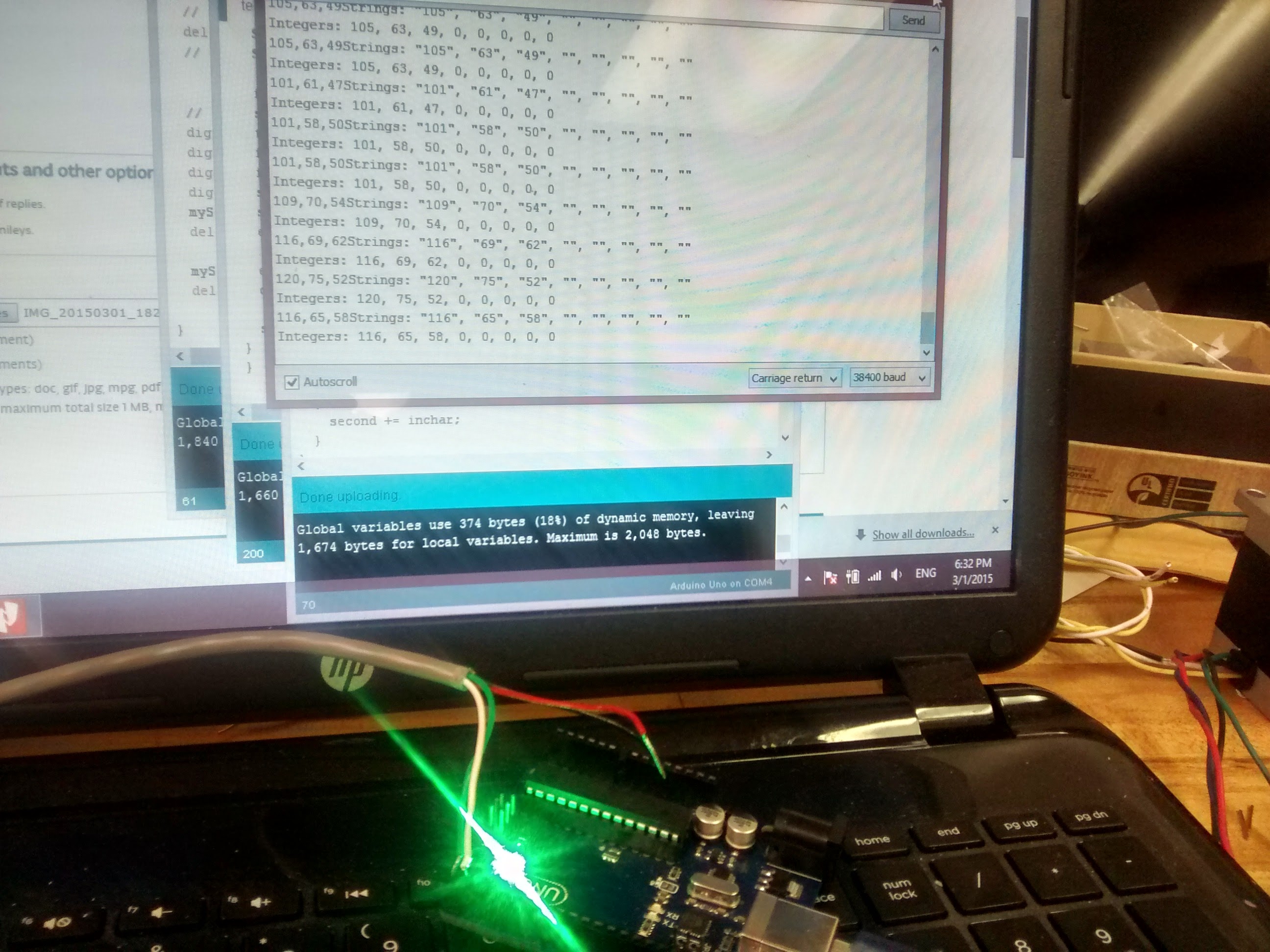

Hello,
I am a new comer to this forum. I am now trying to code the Atlas Scientific evn RGB sensor on Arduino Uno. The problem is when i print the data on the Serial motonitor, all the data are 0. I am so confused and i really need some help.
Here is my code up to now

Sounds like your strings are not getting filled properly. Try printing the strings as well as the integers:

If the strings don't look right there must be a mistake in your code.
Thank you very much for your consideration. I tried your code but it seem like the same problem.
Here what i get in the Serial Mornitor:
Strings: "
Integers: 0, 0, 0, 0, 0, 0, 0, 0
I'm not sure is it because of the code or the wiring or the sensor? Do you know how to check whether the sensor is good or not?
Oh i disconnect the sensor with the power supply (the 5V pin) and it works really well. I' so confused now :slight_smile:
How do you mean "works really well"?
Is it giving you the figures you were expecting.
Can you please post a copy of your circuit, in CAD or a picture of a hand drawn circuit in jpg, png or pdf?
Can you please post a picture of your project.
Tom...... :slight_smile:
This is how i actually plug the sensor in the Arduino Borad and the data i get. It can read RGB quite sensitively. However, i still can not make it read the lx ( say i only get first 3 values for Red Green Blue, the other is 0)
By the way, when i upload the code, i have to connect the green wire to pin 2 and white wire to pin 3, but after uploading, i have to reconnect the 2 wires to pin 0(RX) and pin 1(TX) so that it can show the data.
Here is how i wired up ( i do not have to plug the red wire in)
