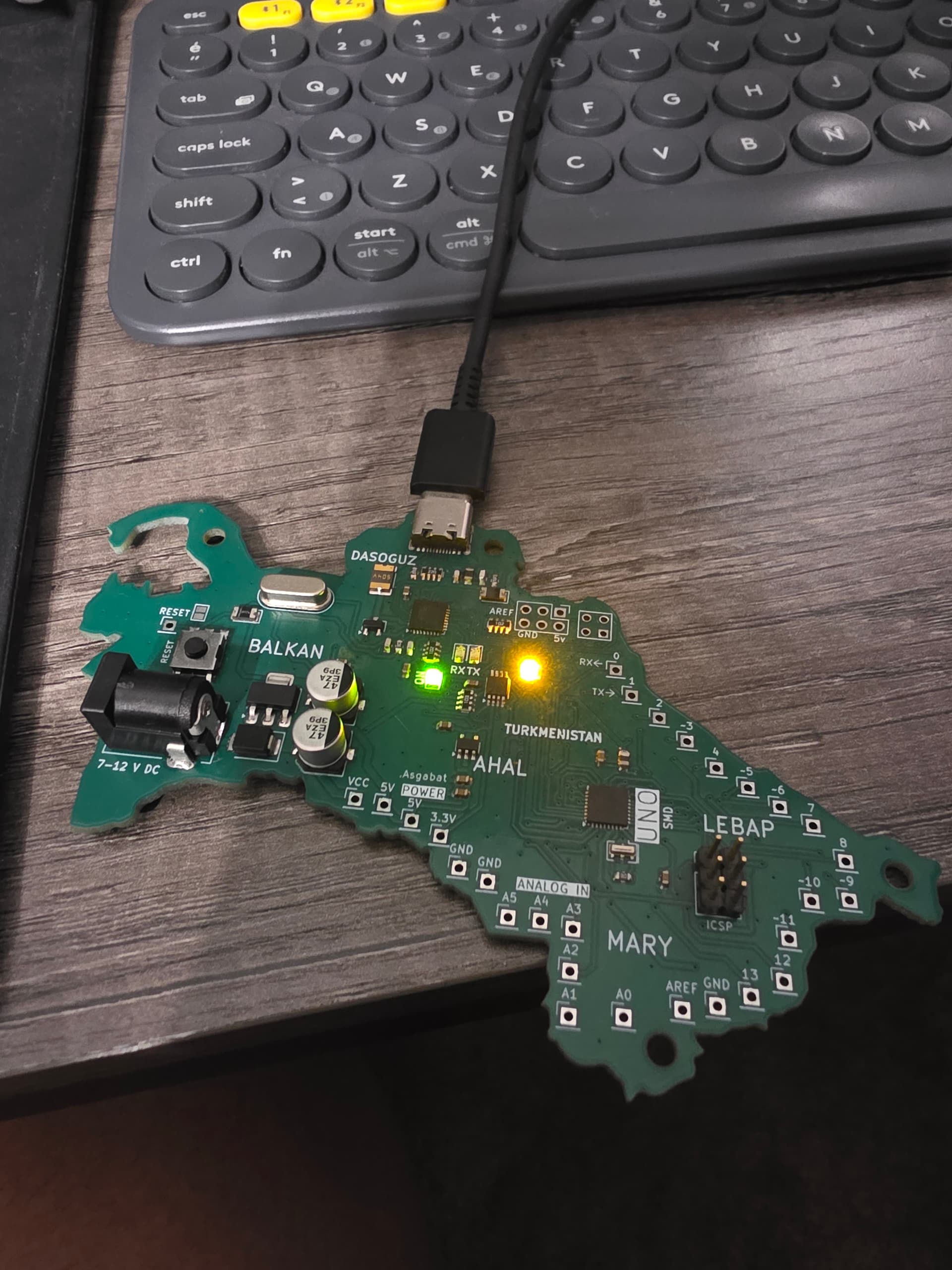

Hi everyone! Hope your doing good. I need some help with my custom arduino uno board. When i try to uploade code from usb-c port it wont do it but if use another arduino uno and connect it with the current one over SPI pins it works.

so when i connected the DIY board to my laptop, my laptop could not recognize it then I did some research and I tried to use FLIP program and updated the driver now my laptop recognizes the board as arduino uno. And then when i am uploading code the 16u2 rx led is blinking but no Tx led, and the arduino ide stuck on uploading....
but if i use another arduino uno as a programmer to code the diy atmel328p over spi pins as target. then both arduino works

If you push the reset button does the D4 LED blink 3 times then stay on?
Yes, it stays on
If you push the reset button, does it Blink 3 times?
I would try the loop back test to narrow down the problem.
It might be a bit tricky on your custom board. You can test both M8RXD/M8TXD and IO0/IO1. Which brings me to double checking the soldering for RN4A and RN4B and other pins involved in the path.
no it does not sir
Then the bootloader is not on the 328. Try burning the bootloader again and make sure no errors are given.

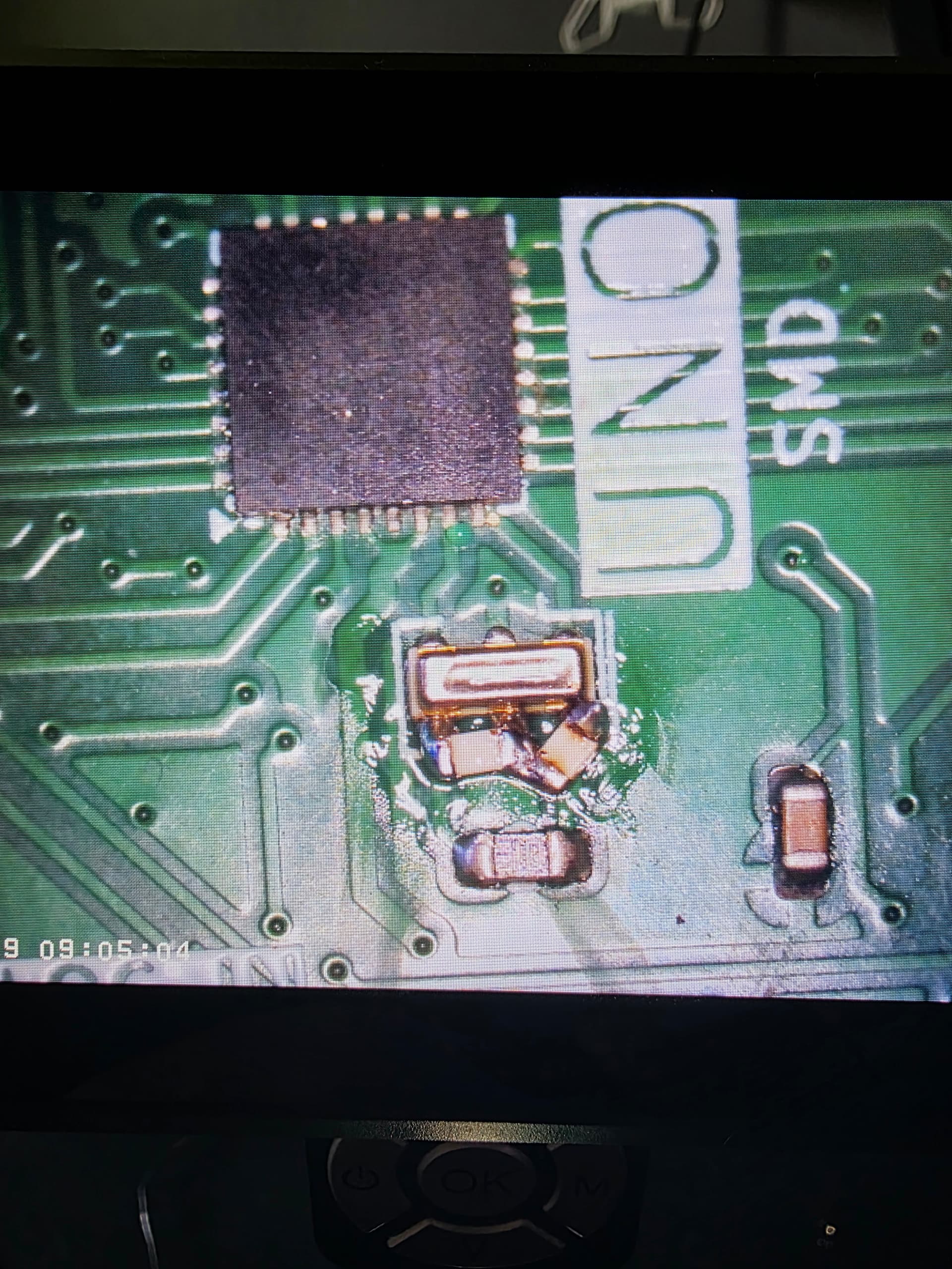

No I do not have a scope, but I realized there are no 22pf capacitors after the crystal.
that's the crystal I have for the 328p. right now I soldered two 22pF capacitors after the crystal and tried to burn the bootloader and still can not bootload
Can you please confirm that i did this correctly?
