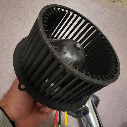

Hi @exidous
Might I ask how you're powering the ESC?
Also, what make/model of ESC and motor are you using?
Hey,
I have this one. Within the settings I've disables throttle calibration, battery protection and tones. I've also adjusted the acceleration to reduce noise on startup.
Power is coming from a Power Distribution module on the car which pulls from the battery/alternator. I expect voltages between 11-14.5v.
This mounts where the stock DC brushed fan speed resistor used to go. The ESC sits directly in the airflow covered in conformal coating.
Hi @exidous
Thanks for the images and link to the ESC information. Looking at the spec it doesn't mention standard 490Hz PWM, I guess it's too old.
It should be possible to get Oneshot125 working on timer 1 output on ditgital pin D9 though. I'm looking into it.
