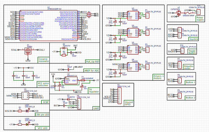

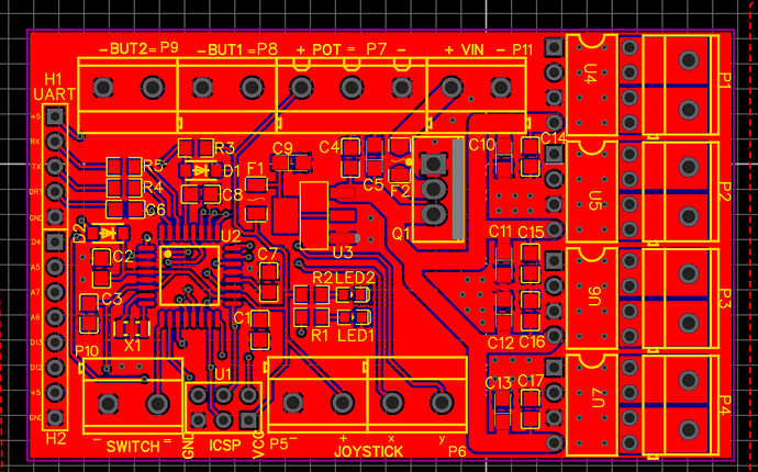

So this is my final version:
1)Added input capasitors for stabilizer ams1117(two bulk caps one before, one after) Did that according to ams1117 datasheet and Arduino Uno scheme.
2)Changed footprints for fuses, I am gonna buy them by myself, so changed footprints on 1206.
3)Added reverse voltage polarity protection from this video. I hope it works.
4)I double checked from some people about TA6586 driver. It seems that it finaly can handle my my motors. I want to make a bet and try to use them instead of drv for now.
5)Switched places for some logic I/Os
6)Lead out unused GPIO(including MISO and SCK). If I am right I can use MISO, MOSI, SCK if i want, since using MISO for ISCP and using MISO as D12 GPIO are not parallel operations, so that should be fine I guess. It is not the same as TX and RX.
7)Added some randoms vias, not sure if they will do the trick with heat dissipation, but I hope at least they will not make it worse.
So this is the final result for now
So yeah, I am going to order the board in about 6 hours. If I made any crucial and life changing mistakes, you are very pleased to give a comment! Thanks everyone for help! I think that it is very important experience for me, I learned a lot, but still not enough. So yeah, I am good to go towards more knowledge!

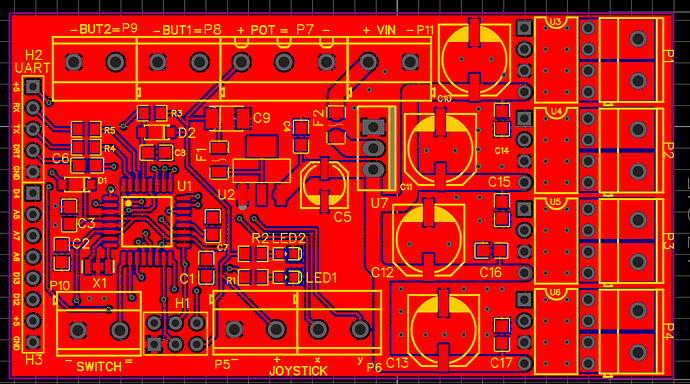

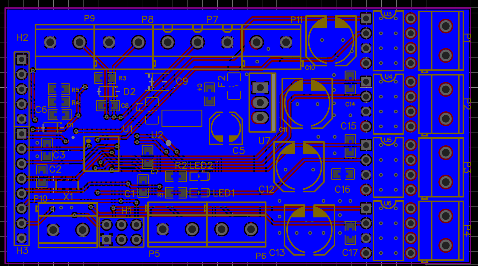

I don't think you can get a 470uF cap in the footprint you've used.
Yeah, I actually see this problem now. There is actually not that many cheap 470uF caps
Yeah, that's why a lot of the boards designed to support motor drivers end up looking like this:
Motor driver chip on little daughter card modules, big capacitor on the "motherboard", underneath where the module plugs in.
You could sample a few ATmega328 chips in DIP form, and capacitors should be very, very cheap when you buy them as a pack.
They help mostly with SMD parts that are mounted in direct thermal contact with the PCB. They won't do much/anything with the DIP motor drivers. They don't hurt, either.
Yeah, should work. One thing to note is the voltage drop across the body diode; all the current for your project under normal operation will flow through that diode, and it has a fairly high forward voltage (~0.8V at 1A). What's saving you here is that your motors have a really small running current, so I'm not too worried. If they all stall at the same time for a few seconds, Q1 will heat up. This emphasizes one more time the necessity to think about how to prevent a motor stall condition - especially a prolonged one. It'll be a race which burns out first - Q1 or the motors.
'Cheap' is relative.
Since your motors are so small, I'd be confident in giving C10 through C13 a 1206 footprint and using a 47uF/16V capacitor in those places.

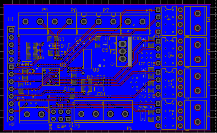

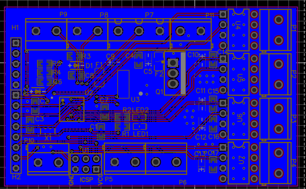

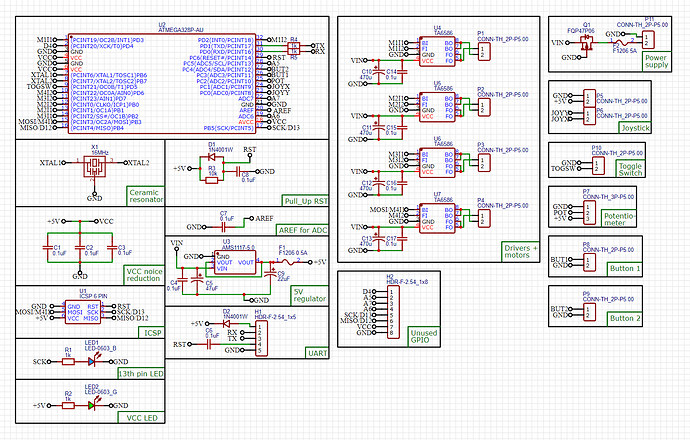

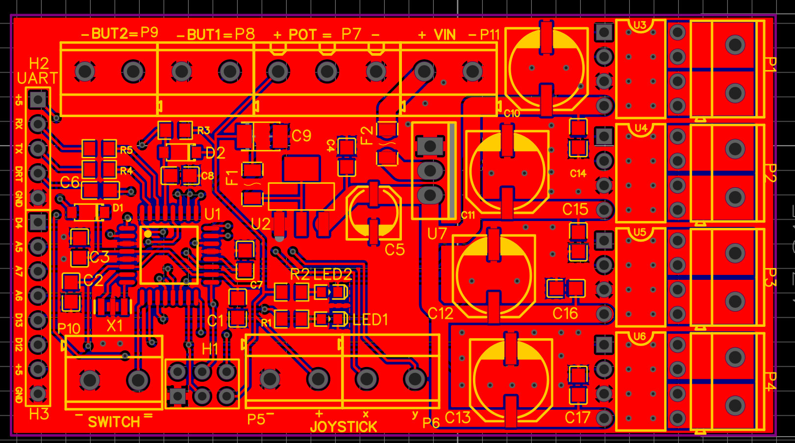

All things concluded, my PCB layout and scheme are attached.
Everything works fine, BUT the only thing that is not working for now is UART. When I press on the arrow, it shows that:

It seems to me that something goes wrong with resetting the microcontroller.
I found this website, and it seems that I did smth wrong connecting the dtr, but I am not sure exactly what did I do wrong.
Get rid of the cap (C8) from RESET to GND here:
While some sort of cap is occasionally recommended there to delay startup when the power supply is "slowly rising", it shouldn't be necessary on a modern AVR (with brown-out detector), and I'm pretty sure it will interfere with the Arduino "auto-reset" circuit.

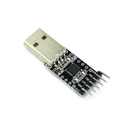

Also: what Serial adapter are you using? 5 pins is a bit uncommon. Are you sure it is connected correctly?
I have this one.
Connected it like that:

Also I found this scheme of connecting dtr from this website website
They do not add a capasitor from RST to GND(the one that you recommended to get rid of), and they add a resistor from DRT to GND, and that is the thing that I do not have, and I don't actually understand its purpose. What do you think about that?
Yeah, as far as I understand, I made a mistake when I didnt connect DTR to GND. They also do that in Arduino Uno, but I didn't get why is it done. As far as I understand I need to make +5V from the other side of capasitor(DTR), so it is +5V on both sides. I need to connect DTR of my board to GND, but I do not understand why do I need to use a resistor for that, if anyone can explain me, I would be very glad! So if I connect DTR to GND, it should be a HIGH on DTR pin of my Serail adapter, so the capasitor will charge and there will be +5V on both sides, when the reset is needed DTR will become low and on the one side of capasitor it will be Low(DTR), while on the other side High(RST), so the capasitor will discharge from the RST side(somehow, somewhere, idk how) and it will be a Low on the RST so, it will reset, and then charge back. It should be something like this, it is hard for me to understand, but seems that there is some kind of logic in that. But I am still would be very glad if anyone will explain me, why do we need a 1k resistor from DTR to GND, instead of just connecting it without resistor. And what happens when DTR becomes LOW? I don't understand, where excatly does the charge of the capasitor from the side of RST goes.
Okey, found more detailes. If I got it right, we need a 1k resistor, so we dont get a a dead short. So we add a resistance, so less current flow. Got it now. The question about where does the charge from capasitor from the side of RST goes is still unsolved.
No resistor between DTR and GND is needed. DTR does not have to be connected directly or indirectly to GND. I can see the sense in adding a resistor between DTR and GND to protect against some kind of spurious input if someone touches a finger to an unconnected DTR line if no UART bridge is connected or something like that. It's really not necessary.
Removing C8 from your circuit should make the auto-reset function work just fine. I've always done it that way. If you feel the need to add C8, I'd make sure it's a lot smaller than C6; use 10nF or so. But start by simply removing it.

Grounding DTR generates a pulse on the other side of C6, because a capacitor's series response to a step function is essentially differentiation. C8 does it's best to absorb that pulse, because a cap to ground is an integrator. Since they're of equal value, I'd guess that the amplitude of the resulting RESET pulse is about half what it ought to be. Essentially you have a voltage divider made of Caps, that works on pulses.
