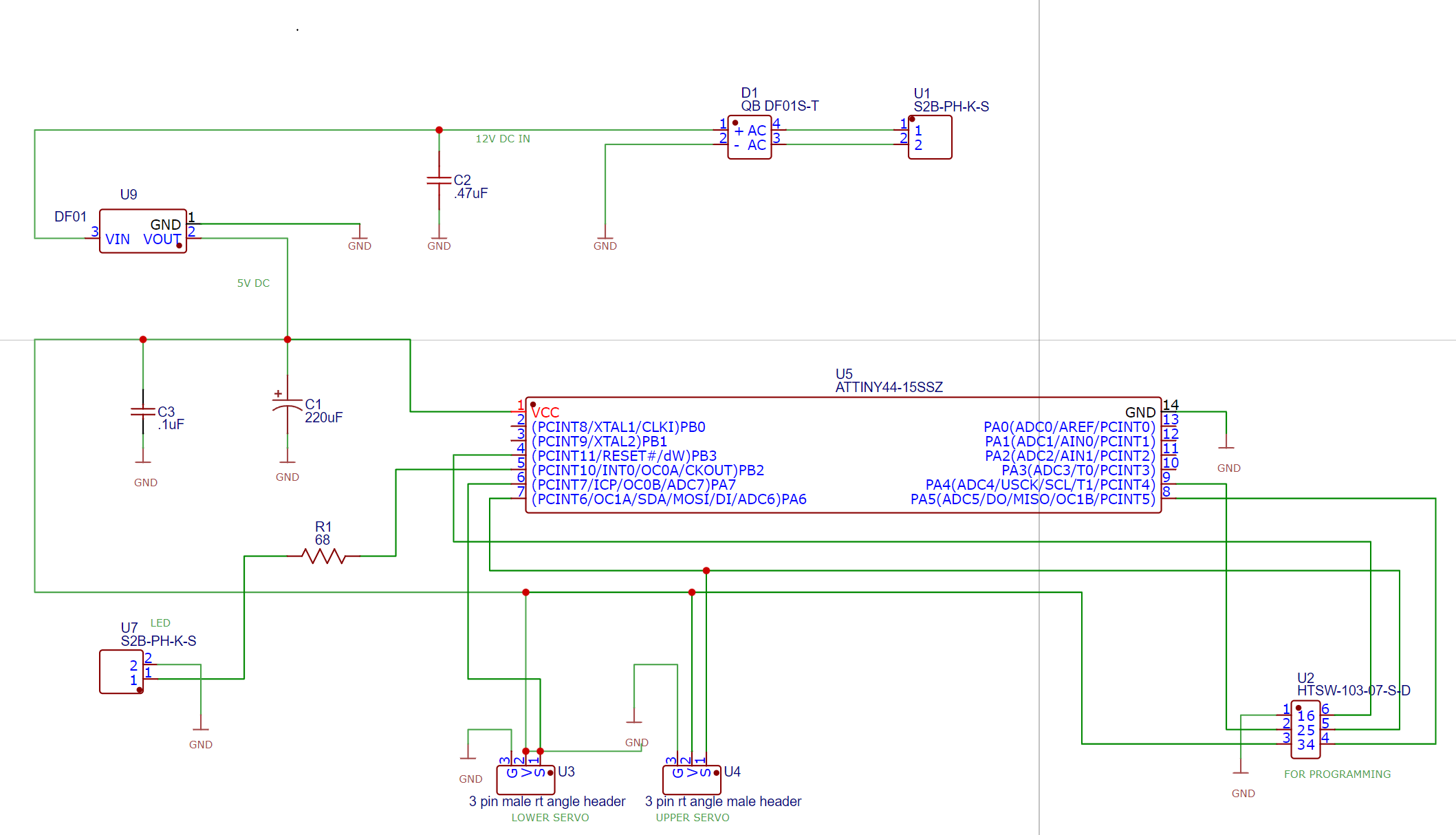

I think that I have run into as limitation when down scaling to production. I have a circuit that is running two servos and PWM a LED ( I.e. analogWrite - fading).
On the ATmega328P (Arduino Uno) the circuit and IDE sketch works correctly, but on the attiny85 (or attiny44) the servos.work but I cannot PWM the LED.
Is this due to the fact that the ATmega328P has 3 timers and the attiny only two?
Also, I have the Attiny running at 8mhz (instead of 1mhz - so I can get better resolution on my servos) versus the Uno that runs at 16mhz.

'm currently using an ATTINY44 (but have a ATTINY85 on order) I'm using PB2 (physical pin 5) for my LED PWM, and PB6 and PB7 for the servos. On the UNO I'm using pin 3 for the LED and 9 and 10 for the servos
I change port of my LED to PA7 (pin6) and lower servoA to PA5 (pin8) and servoB to Pa6 (pin7) and it is now fading the led but servos are acting glitchy...
I discovered that the glitchyness was cause by the softwareserial I had running so I disabled it and looks like things are running smoothy just by switching ports so that servos are running on PA6 and PA5 while LED is runing on PA7,
