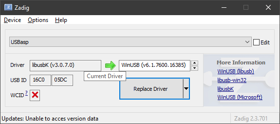

I just tried what you did by plugging a Atmega8 in my Uno and then I burned the (minicore) bootloader via a USBASP connected to the 6 pin ICSP header on the UNO board.
That worked flawless, so the first thing I would do if I were you is try out a different USB driver for your USBASP
I use Zadig to do that (Windows PC)
The driver that works for me is the libusbK (my current driver). When you check I suspect you have the WinUSB driver, that sometimes gives me trouble recognizing the USBASP.
When playing a bit with the AT8 UNO I noticed that after I upload a (blink ) test sketch via the bootloader I could not re-use the ICSP header to program via USBASP. I got the exact same error you had.
After that error I had to use Zadig again to reinstall the libusbK driver which enabled me to do burn bootloader again.

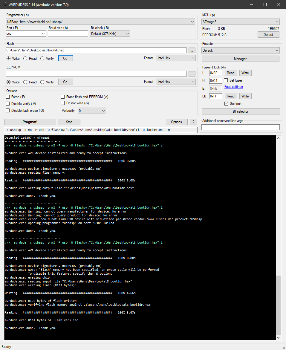

I extracted the bootloader from my AT8-UNO
at8 bootldr.h (19.3 KB)
(rename to at8 bootldr.hex)
How to set the fuses you can see in the avrdudess screenshot
