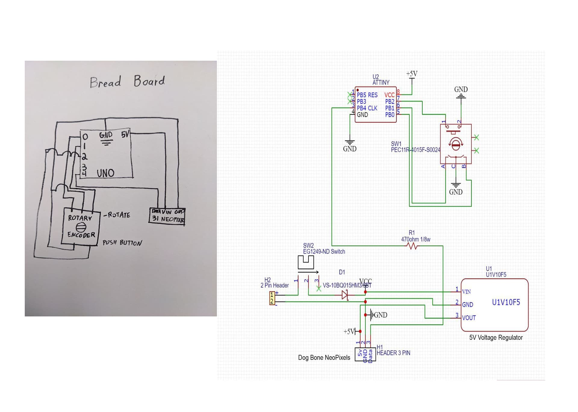

So I've got an odd issue, or one that I don't have a clear answer for.
My code works exactly how I think it should on the bread board:
1)Turn On a set of NeoPixels
2) Adjust color using a rotary encoder.
- This is through the "check color state" function below which I think is where the issue is?
3) Change patterns through pressing the button of the encoder, while still allowing the color to change from the rotary encoder.
The general run of the loop is:
- Run Effect - Run one of 12 cases of a switch fuctions
- btn. tick - Check for Button Presses to advance case number
- Every 10 mSec, check for a state change on the rotarty encoder to adjust hue value
- Push the output information to the LEDs
- Repeat
When I got it all to a satisfactory level to test on the final product - a light up dog bone - everything worked except step 2, the color adjustment.
I changed the button input to both read one of the two rotary inputs, and then the other, and both times the pattern did change when the rotary encoder was turned, so the board is reading both pins as far as I can tell.
If anyone has any ideas/input I'd greatly appreciate it as this is my first larger project and I've hit a wall troubleshooting farther.
Code is below, as well as a schematic I drew of the bread board, and then the schematic my friend made for the final product.
This is also a video showing intended function vs what is happening of them side by side. The bread board one goes through red, while the other one doesn't change color.
